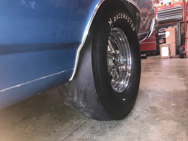

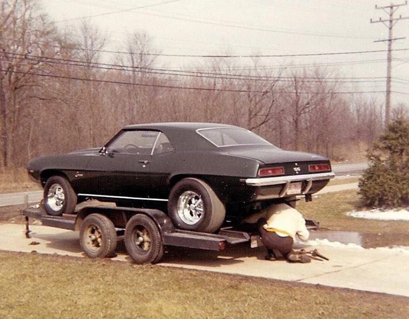

Hello Everyone,
I could use everybodys help I have a 1969 Camaro X44 car, nothing special. But I want the day 2 look. I need to know what wheel and tire sizes are on this 1969 camaro . That's the exact stance I want. Does anyone else know if it had air shocks on it as well. I love Grady's Brown Copo car when he had the Cragars on it before the resto. Thanks for the help!!!!

Shackle extensions and likely has air shocks as well. Hard to see but would say it looks like a pair of shorter profile 50's on the back. Profile looks like H50's mounted on 8" rims but can't say for sure as they could also be L60's. Looks like it might have 5" fronts but again, hard to determine. Definitely has bigger front tires in the second picture.

I think that may be an air shock nipple right under the SS emblem. Not where I would have put it but to each their own.

15x8 reversed (deepdish ) rear.
Fronts bottom photo 6" or 7" wide fronts. Not sure if 14 or 15 on front.
Hard to say on the slicks. Probably 10" wide.

Looks like it's sitting higher in front in the 1st photo,compared to the 2nd.

Might be the 90/10 shocks in the front, when he wrenched the tie straps down and pulled on
the front end some...lifting the front up? Just a guess!

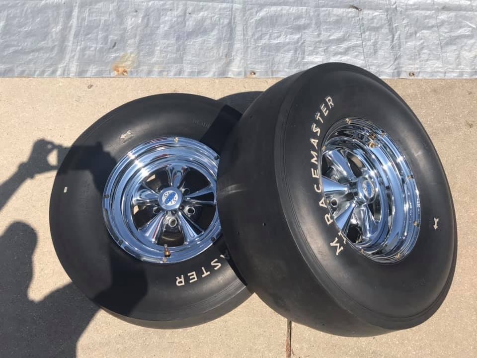

These are 15x8 with 4.25 bs. The tires are 29” tall and 10” wide....those wheels and tires on the rear of that Camaro are at least 8” wide if not 10” and I think the tires are all of 10” wide if not wider. I realize that they are reversed wheels but they are really wide......same with the tires. iMO Maybe the reversed wheels are throwing me off.....or the smaller wheel well on the Camaro.
