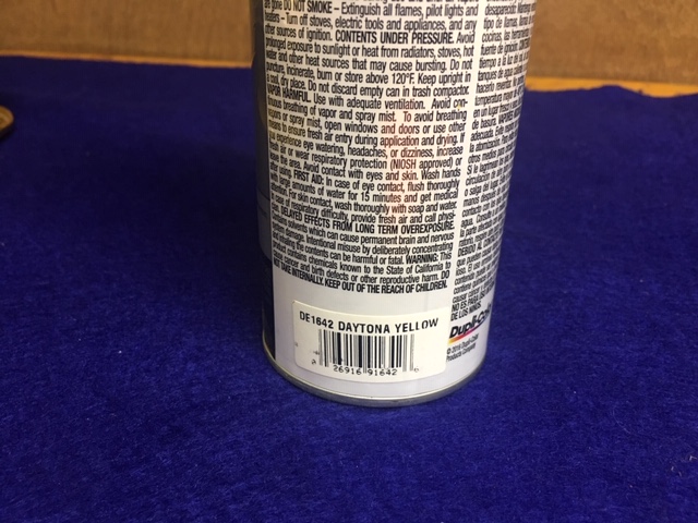

What brand/shade paint have you all used to replicate the yellow for traction bars and the red for Lakewood driveshaft loops/scattershields?
Attachments - The Supercar Registry C79BCE42-14ED-49FA-9247-395F73766542.jpeg 1349C48A-EBAD-4CC1-A44F-BE60091A1222.jpeg

I used Tremclad Professional "Safety Red" Model # 5707564838 Aerosol for the Lakewood Roll Bar and Driveshaft Loop. Based in Grey primer this gave it the perfect color with 3 good coats of paint and closely matched the factory bell housing color once it cured.
For the Traction Bars I used Duplicolor DE1642 which is a Daytona Yellow aerosol. Same thing with a good base in grey primer then 3 good coats allowing them to dry between coats. I think they look great as well but that can be subjective.
Hope this helps?

X2 on the Duplicolor DE1642 Daytona Yellow for the Lakewood traction bars.

Thank you Guys - that is exactly the help I needed! Will post pics of finished product when I get there.
