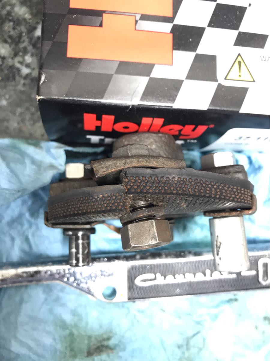

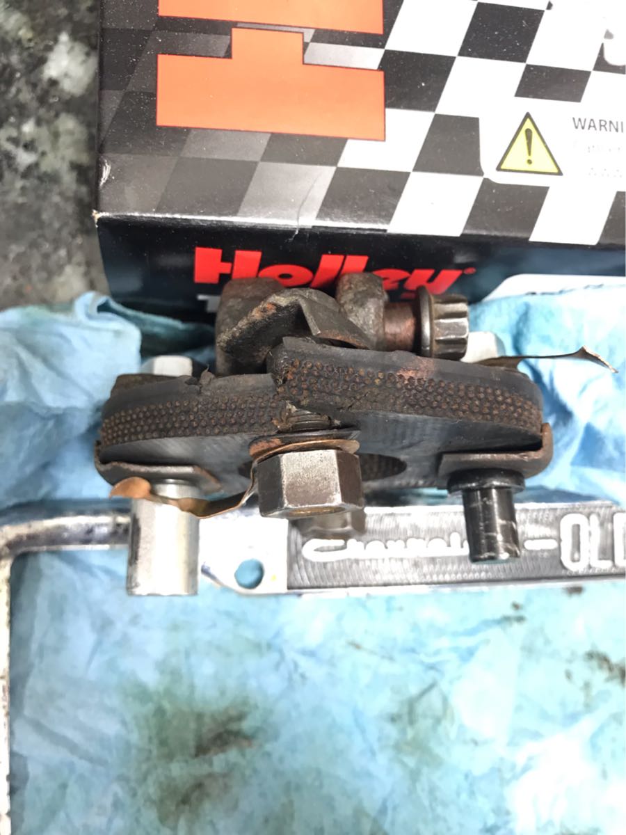

I wanted to give all a heads up that the rag joint in my 69 Chevelle just ripped and the steering failed. Thank God I was in my driveway. I told Lares to replace the rag joint when my box was rebuilt but I don’t think it was. I think they just put new studs in the rag that mate up to the flange. I should had inspected it very closely. I put on a repro from NPD. Far from correct but had to do this because the car was blocking my driveway. Just want those with questionable rag joints to replace them. I had been driving the car down the interstate at speeds and zipping down city roads with 100 year old oak trees just off the curb. I am glad this thing crapped out in my driveway!
I put the rag back together but you can see where it ripped. The repro has polyurethane for the rag instead of the regular rubber.

do you have manual or power steering?
if you have manual steering that rag joint should be a 7 row dotted thread showing, I count only 5 which I think is for power steering.

Manual steering. There are five rows of dotted threads.
