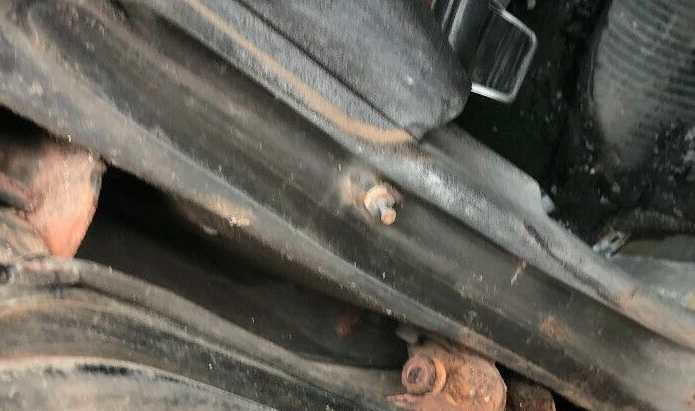

best guess on the VIN stamp is 651114

Possible original tuxedo black car? If so, probably why the tag was knicked.

Bottom line, it's a pile of mis-represented swap meet junk.

This car has a 1969 Camaro L78 in it and a 1969 Chevelle M22. The car is most likely an SS 350 car in my opinion. 2 fuel lines, small block heater box, BS coded 12 bolt, exhaust hangar on left frame rail, brake prop valve on left subframe.
