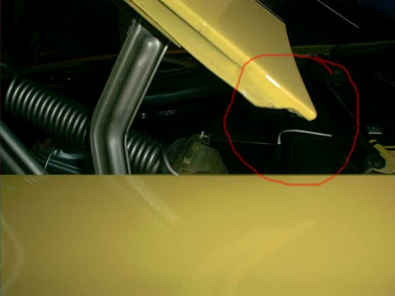

Easiest way to tell is look at the side edge at rear of hood , repo hoods end in a small approximately 45 degree angle. GM hoods have a small notch out of the 45 degree angle. Production line installed hoods also have a week production code stamped in the drivers side at the rear by notch. Hope that helps somewhat

Hood GM.

Hood Repop

Now I understand. Thanks for the pictures.

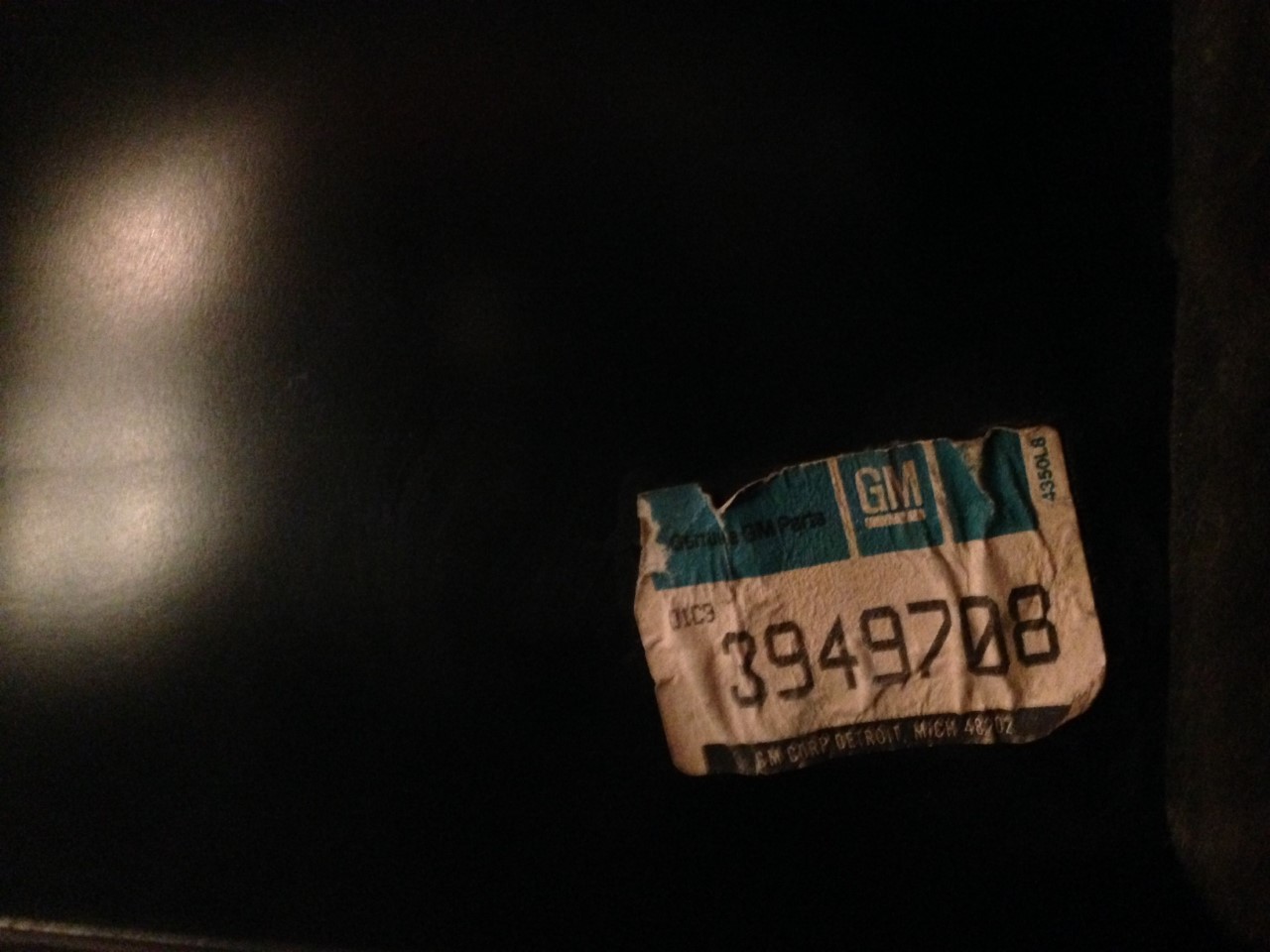

A couple pics of my 69 hood with the GM sticker intact.
