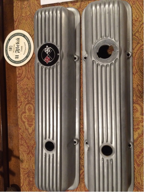

hi
need help please with the correct way to restore my deuce LT1 valve covers
fro cleaning / striping/ and what finish to put on them?
thank you
chris
1970 citrus Yenko Nova
Attachments - The Supercar Registry valvecover_before.jpg valvecoverPrior2.jpg valvecoverfinish.jpg Valve Covers.jpg

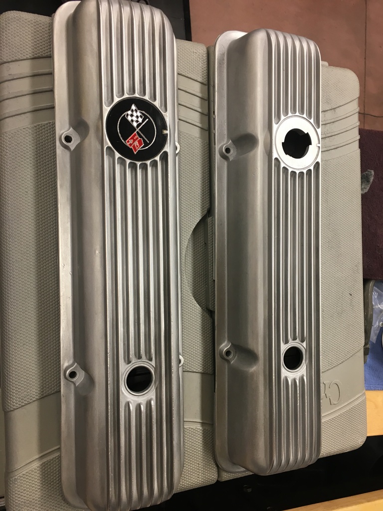

I recently cleaned up the valve covers for my 71 LT1. I feel like they look right as far as the finish color etc.
I used organic PH neutral cleaner then used neverdull cotton wadding, however they were not too dirty when I started....
The FIRST PHOTO IS FINISHED
TWO SECOND PHOTOS ARE PRIOR TO CLEANING.
