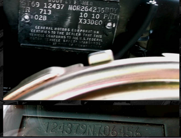

Something(s) off here. X33D80 on a February tag? I didn't think that appeared until spoilers were standard in April? And a 700-series VIN? IN Feb??
Sorry if re-post

http://www.camaros.org/forum/index.php?topic=16984.0

Yep, this cars been for sale several times for over a year and has obvious issues.

At least it has a silver grill.... except they even painted the surround silver.
Wow. So many issues.

Shouldn’t it have the rosewood treatment on the glovebox door & related pieces?

Subject VIN 124379N706456
Beautiful car and too bad it’s been messed with.

Who knows what the car started as, I'm surprised it has attracted so much interest. This a a car you should run from...
