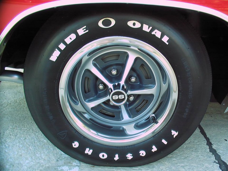

Wanted some opinions about these lug nuts. Are they original SS wheel lug nuts? 1st design or 2nd? The seat looks really small compared to anything else I have seen.
Thanks Scott

That's how small the seats originally were.And if they're 7/16 too,they're definitely the 2nd design.
That small seat probably explains why the lug seats are destroyed on a lot of AO/YA wheels.
Almost 99% always, stupidest designed lug nut EVER, JMO. First dummy with a impact wrench trashed the wheel.

Found this old thread on the subject of SS wheel lug nuts, maybe some here can find some usefull info ?
https://www.yenko.net/forum/showthre...ighlight=wheel

Yes,but not always.
