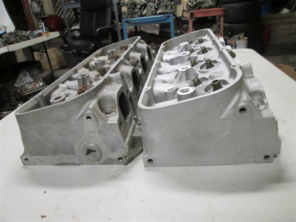

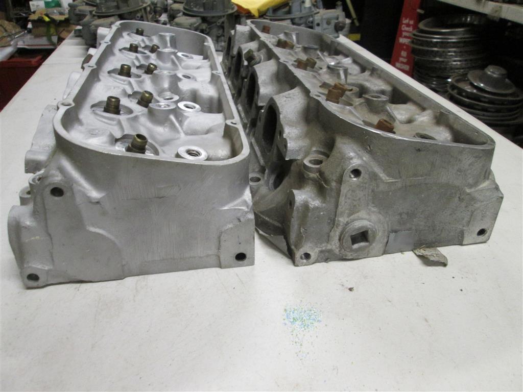

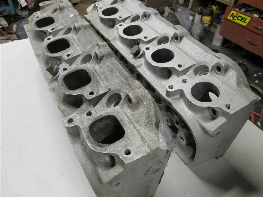

first set is 074 second set 842 looks like exhaust ports are lower on 842
