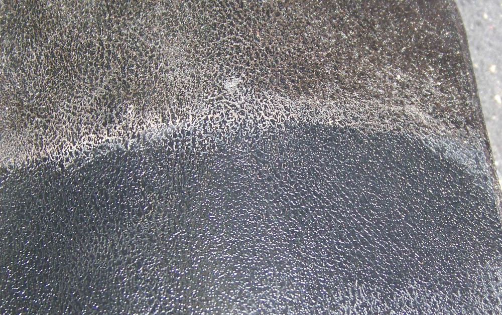

I just removed the gum off a horn button for a 4 bar Z28 steering wheel using KABOOM foaming cleaner AND a toothbrush.
Denatured alcohol also will not harm vinyl or rubber... it is used for cleaning rubber and vinyl in the printing industry. I use it to remove all kinds of sticky and tacky gunk.

FWIW what is happening is the plasticizers (the additives which make it flexible) are leeching out of the porus material.
Here is a 69 DASH PAD which was so sticky that it would pull lint from a cloth...
Cleaned with denatured alcohol...
~JAG~
