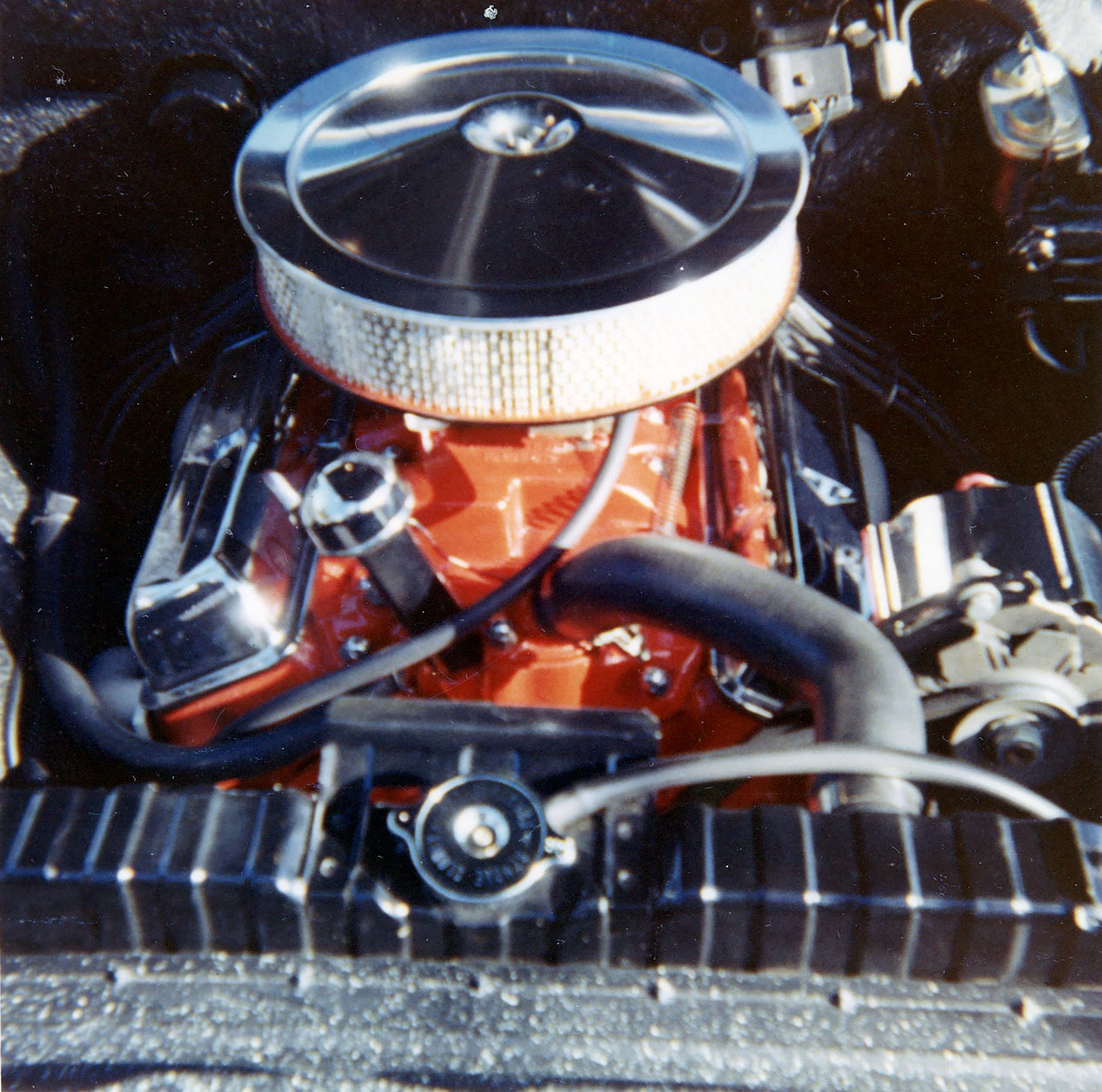

Engine: Mod 1 and Mod 2....Mod 1 I'm calling the orange intake with chrome valve covers and Mod 2 I'm calling the silver intake with finned valve covers.

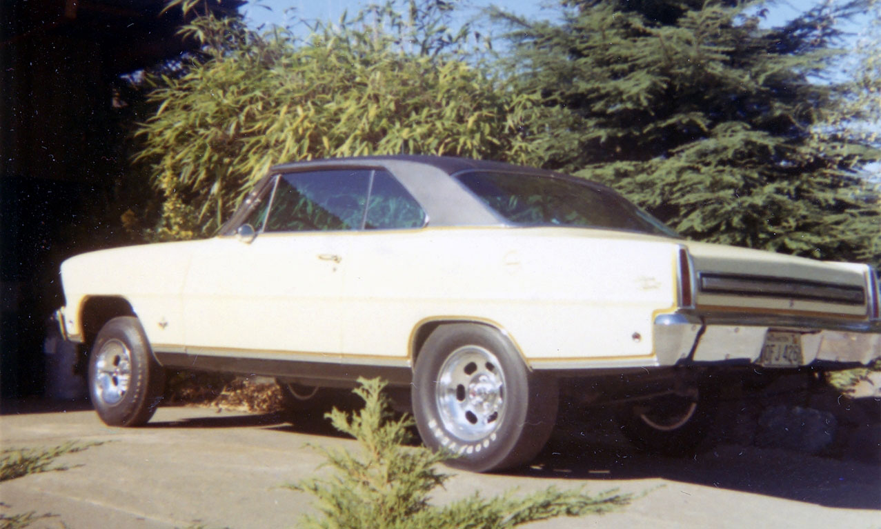

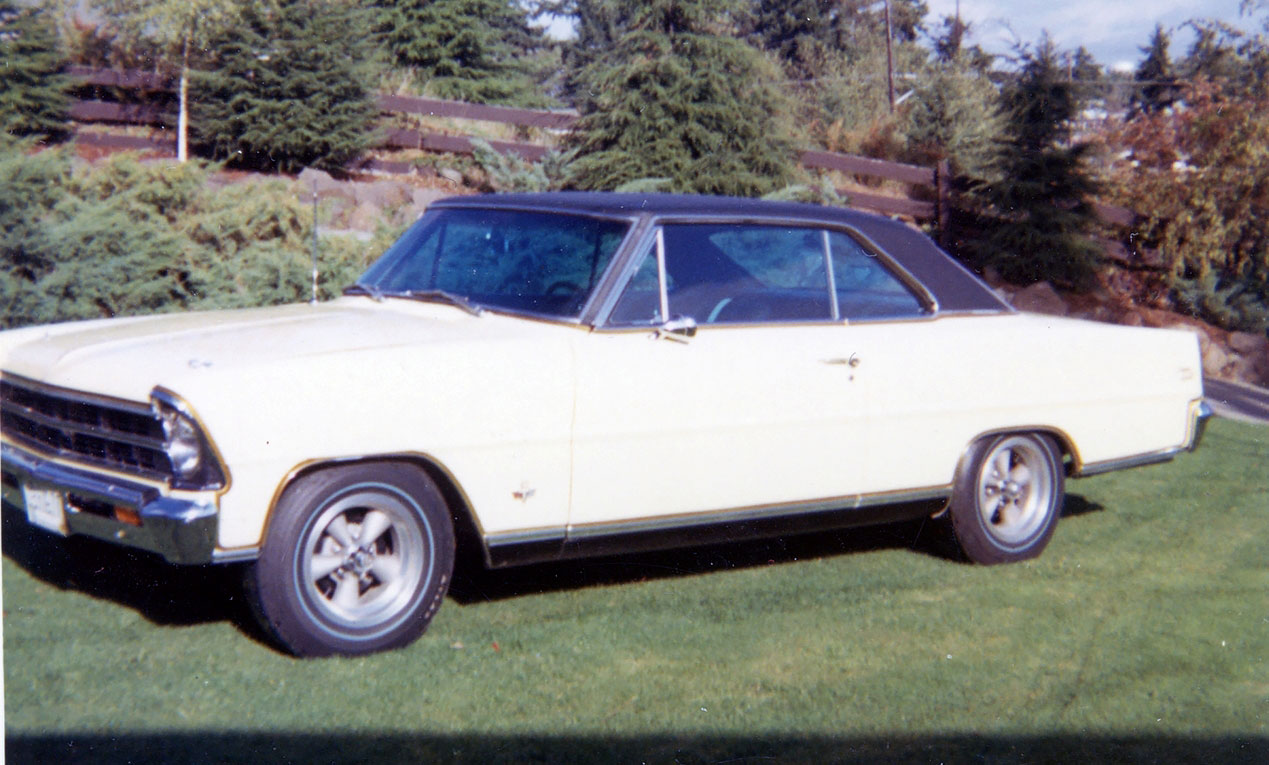

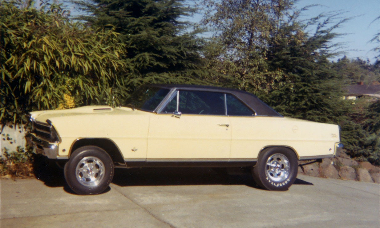

Wheels: What wheels with white walls and what wheels with slicks and jacked up front end?

Stock height, looks like Torque thrust 2's for rims. They both have aftermarket manifolds, it looks like. Factory L79 chrome valve covers on the first pick. Neat car...does your dad still have it or you even?

Those are not white walls, they have blue stripes. Probably Good Year.
I've got a pair of 6 hole 8 1/2 inch slots like those. They are market Universal Wheel USA on the back.
Freddie
I had always assumed they were white walls that were new and hadn't had the blue washed off.
Thanks for the idea on the Universal Wheels USA...I usually see this style wheel in 5 slot but these are 6 as you mentioned...

I've never seen valve cover vents like that before.
The intake manifold in the first picture looks like a L79 intake that has been painted orange.

Possibly Cal Custom aftermarket finned aluminum valve covers.
