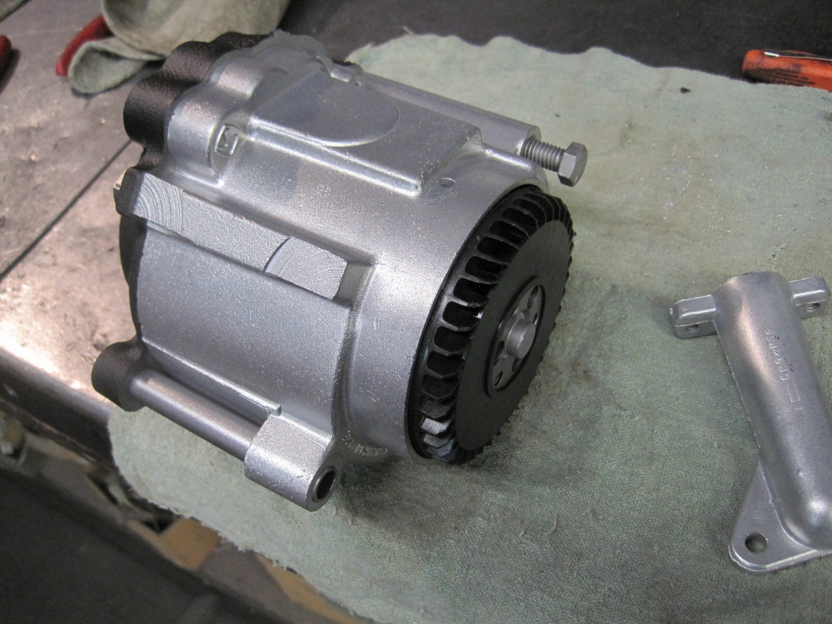

I know it is not what some like but here is what I can make a pump look like.

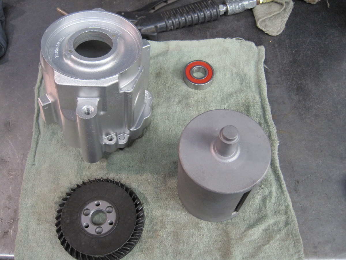

If I could ask, how did you get the front bearing out without trashing the case, and how are you going to retain the new front bearing ?
Thanks Mike
I just press out the shaft with the bearing and then used green loctite sleeve retainer on the bore and new bearing.
