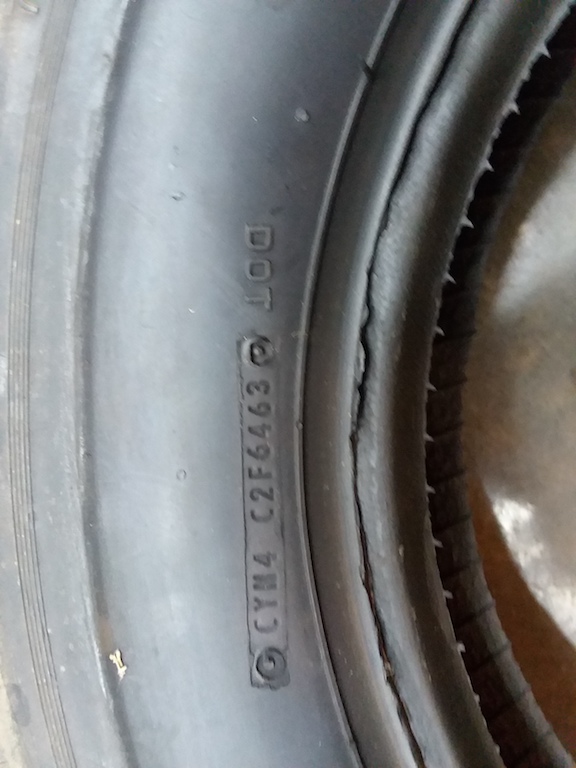

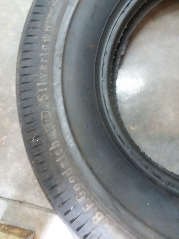

Can somebody tell me if this is an original or repo tire? It's a redline BF Goodrich.

It was manufactured after 1971 . the last 3 digits 463 contain the date info. 46 =week and the 3 is the year 73, 83, 93

Thanks Steve. Any idea if they were still producing redlines in 73?
