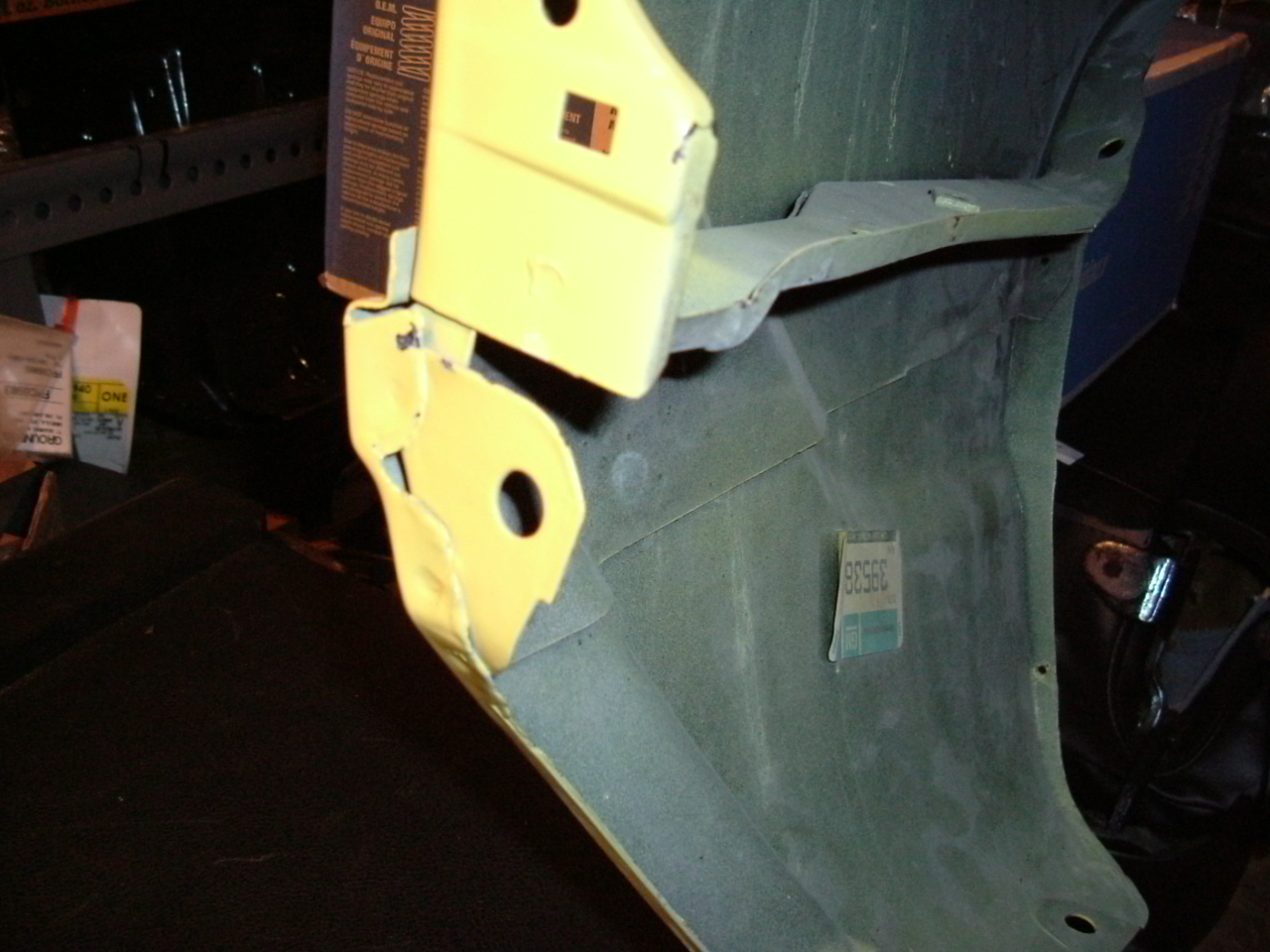

Anyone have a picture of where the front fender braces go
Attachments - The Supercar Registry 69 Chevelle filler panel and fender 006.JPG 69 Chevelle filler panel and fender 002.JPG

This is where the core support meets the inner fender and filler panel. The other end of the brace mounts to the hole at the bottom of the outer fender, just forward of the front tire. It is the only hole there.

The other end of the brace mounts to the hole at the bottom of the fender where it curves under.
