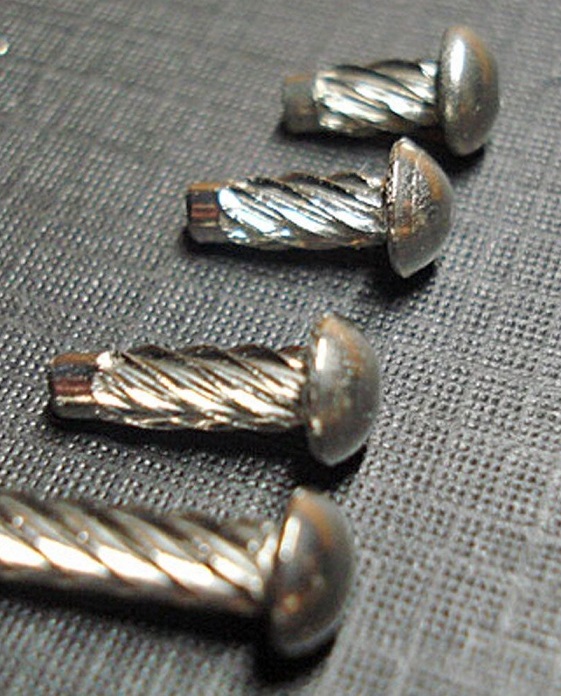

Drive screw
https://www.hansonrivet.com/rivets/drive-screws/

For reference...This is what you need.
