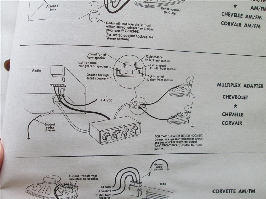

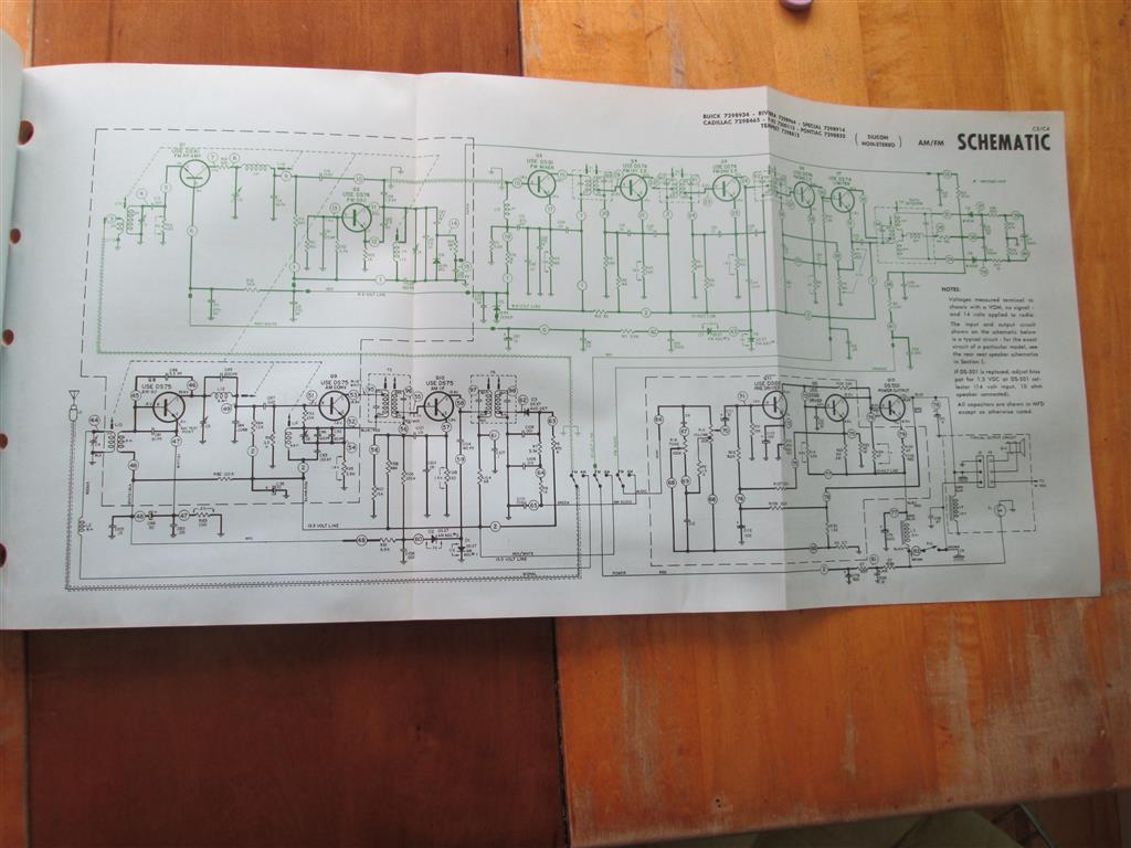

Old 05-04-2018, 06:06 PM
Join Date: Sep 2001
Location: Santa Cruz, CA
Posts: 6,591
Thanks: 411
Thanked 735 Times in 381 Posts
Here are pictures from a 67 manual I have.
Jason

SuperNovaSS ,
Thanks very much for this information.
Looking at the drawings you have provided it only shows two ground wires for all four speakers. One for the front and one for the rear.
Does anyone know if I just run a ground wire from the LH front to the RH front at the speakers?
Also the same for the LH rear to the RH rear at the speakers?
