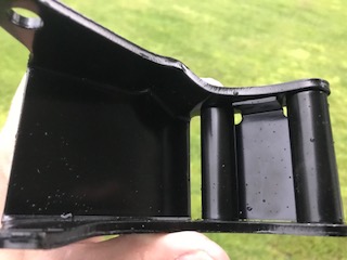

Here's my review of a reproduction CHQ GM licensed 67-68 SS350, Z-28 PS bracket.
It looks nice but the bolt tubes are attached with 2 tiny spot welds shown on upper tab in pic. I can move that piece around with my fingers.
Some re-welding on the tubes is in order here to fix this.
In the meantime I will keep searching for an original while I contemplate returning the repro or fixing it. Too bad as I have every other pulley and bracket nos for the SS350.

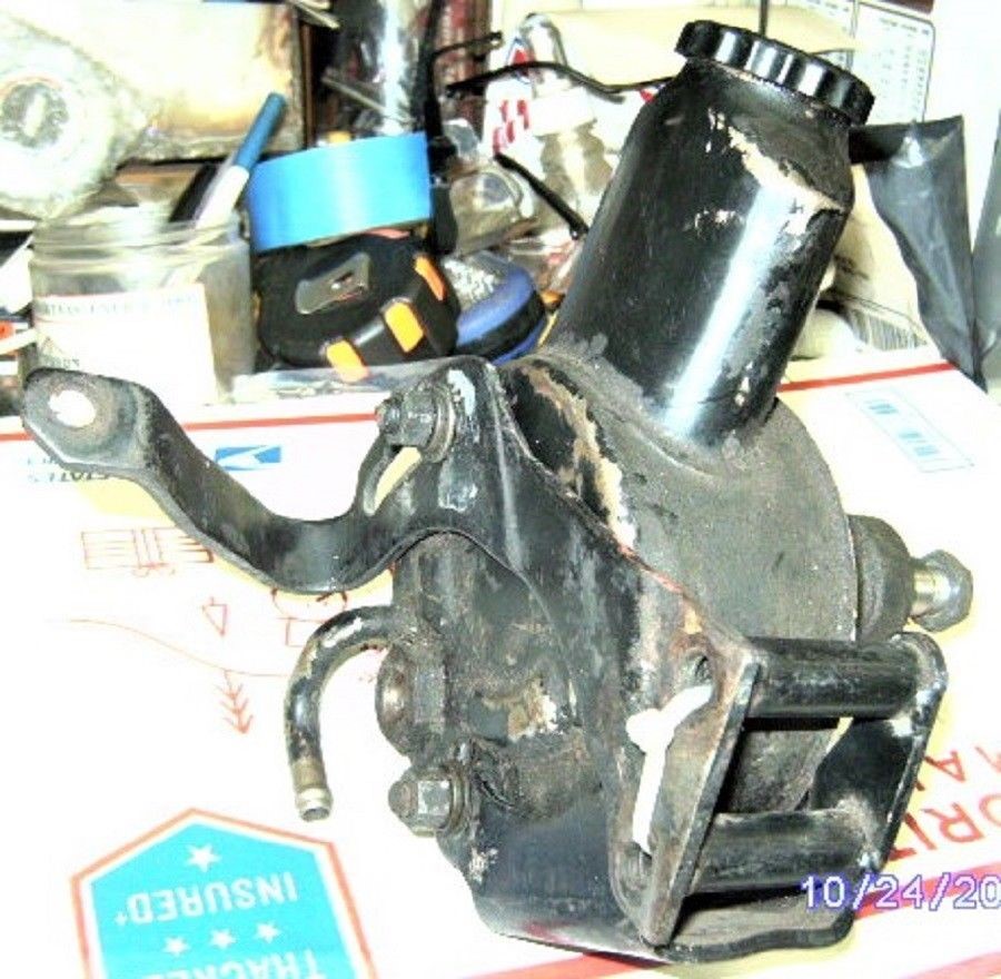

This looks original? Welded tubes. no flimsy spot welded tube bracket. https://www.ebay.com/itm/1967-68-Z28...BZ8CV3&vxp=mtr
