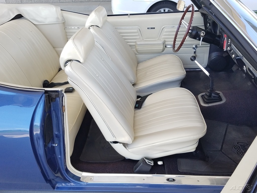

Default Dusk Blue '69 Chevelle SS396/4-sp Convertible
Beautiful car, love the buckets with no console, assume the seller's description of a 'correct' 396 engine means the born-with motor is gone. What do you believe is a reasonable price for this one? The dealer has it listed at $75k but that's high IMO for a NOM car.

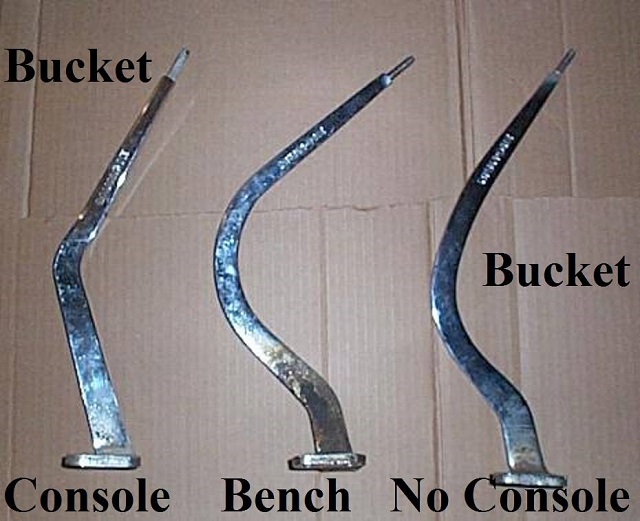

Good looking car.
It's holding the wrong Muncie shifter arm for a no console/bucket car though.
Looks to be for one with a console.
