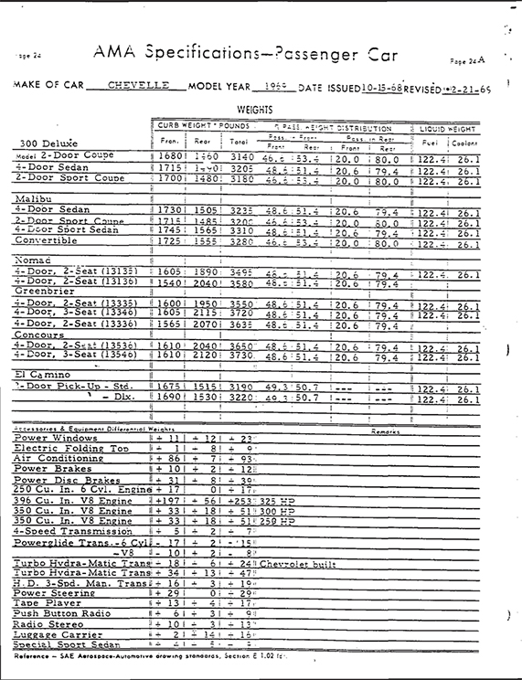

On a Chevelle Facebook page there has been some discussion (and a lot of inaccurate information) about post cars, specifically the 300 Deluxe SS cars. A question was asked in regards to weight of the post cars versus the hardtop/coupe.
I was always under the impression that the post cars were lighter and obviously stronger. But the question is if the post cars are lighter in an apples to apples comparison to a hardtop, by how much lighter and where are the areas of the post car that make it lighter?

Thanks Lee. I was under the impression that the post cars were around 150/200lbs lighter.

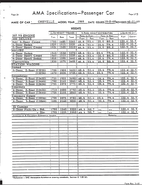

Info is pretty readily available on the GM Heritage pages for each year.
1969 Chevelle:
https://www.google.com/url?sa=t&rct=...hjmYF2fR_LdjKq
1970 link:
https://www.google.com/url?sa=t&rct=...PBHpDimNGRf7JV
Hope this helps:
Pgs 137-138 attached
Paul

I've always found this question interesting as well, and hard to pin down.
If I'm reading the Chevy data correctly, it appears to indicate 40-45 lbs (using the difference between the 300 deluxe and 300 deluxe sport coupe).
I was trying to find Olds data a while back... shipping weights for '68 Hurst/Olds between the holiday (non post) and sport coupe (post) were only listed as a 10 lb difference. The AMA specs show curb weight at 3726 vs 3716, and shipping weight as 3568 vs 3558.
I've seen other numbers that indicate 20-30 lbs difference, with an overall range from 10-50 lb.
If anybody else had better info, it would be interesting to know...
