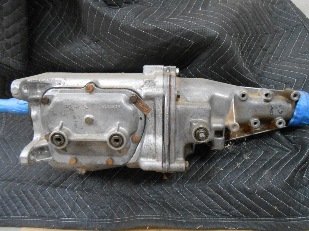

Hello folks
For a 69 Nova which is the correct side cover for full functionality, ie neutral safety switch, and if I have a 68 dated trans would there be any other recommended functional updates. I am not a 100 % numbers guy for this car just want correct look and everything to work as it should factory wise.
Thanks!

There will only be a switch port on 70 up Muncie side covers.
The neutral safety switch is on the column on your 69.
Your 68 trans if fine as it is for 69.

69 had a "306" casting cover and the shift levers were retained by 3/8" bolts 69 had a stud with fine thread nuts
heres cover on the auction - not mine
https://www.ebay.com/i/263333954932?chn=ps
reverse shaft is incorrect in the picture
