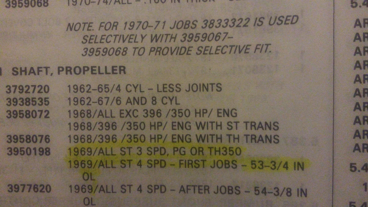

FWIW some prop shaft sizes from a gm parts catalogue for chevy II and nova , here's a pic.

That's some very very good verification! Thanks marshal!
