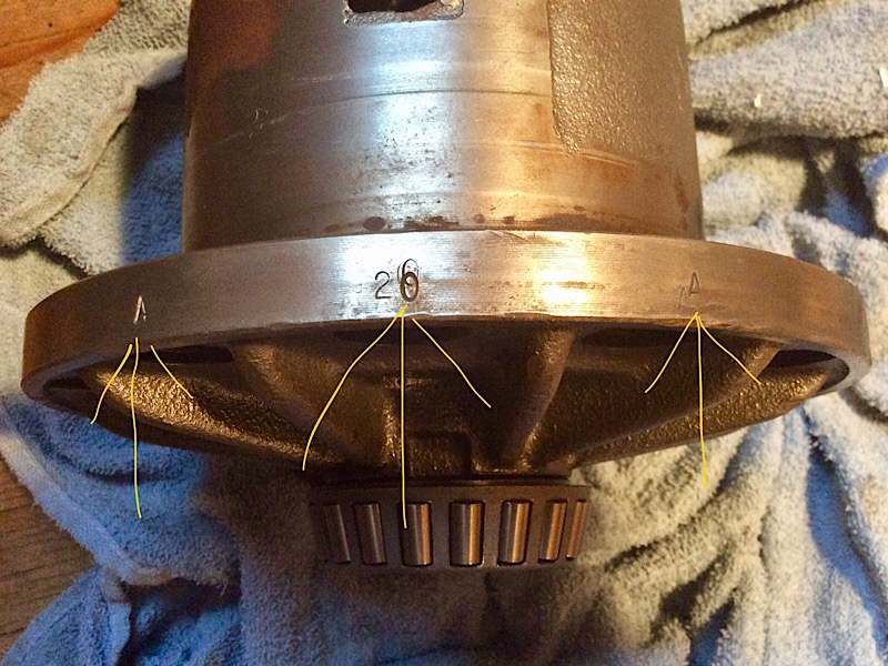

Hey all
I bought a EDB 30174 carrier for $200. Its in beautiful shape from what I can see.
It has NDH bearings still on it.
There is also pink, yellow and blue paint marks on it.
The springs are green.
Did the factory put these colored marks on it? For what purpose?
I have a set of GM 4.30 gears im going to try.
Attachments - The Supercar Registry 06379DD9-7A44-491C-B31C-43C6C5F25729.jpeg

Anyone know what these numbers represent? Date code?
Anyone?

That's a nice date on that posi, it translates to Jan. 20th 1970
A= January
20=20th day
How do you know the 2nd “A” = 1970?
Thanks much for the help
