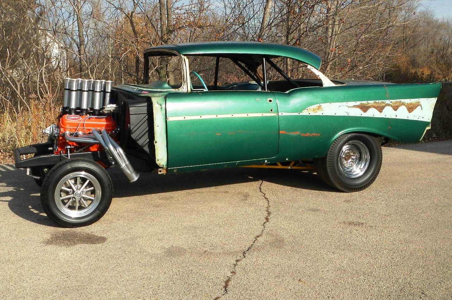

bought a57 chevy,need to put 8.5 slots on the back,but wont go past the springs,should i buy a kit that springs mount under the frame rails? also adding 15 inch tires instead of the 14s on it,.need that fat tire in the bach! deep dish slots! help,any body!

You ain't running 15 x 8.5's unless you raise that 57 like a 4x4 and they will then stick out a couple of inches past the fender.

Moving the springs in board will get you some clearance, but as Whitetop has stated you'll also need to lift the car if not tubing it. Check out this link.
