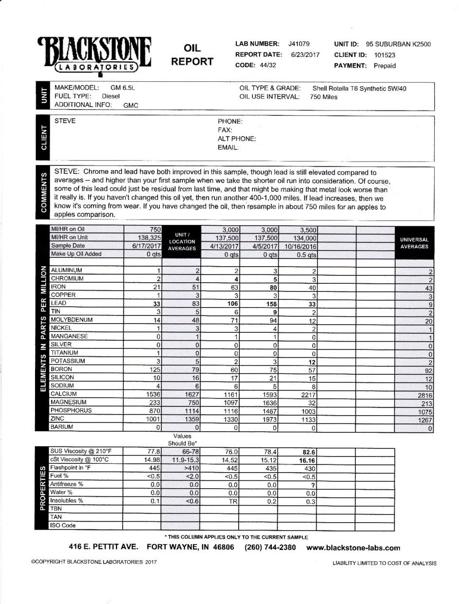

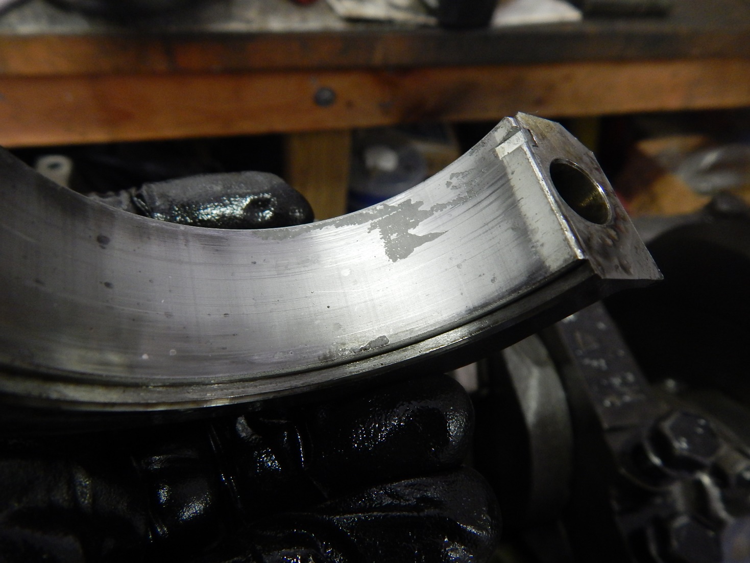

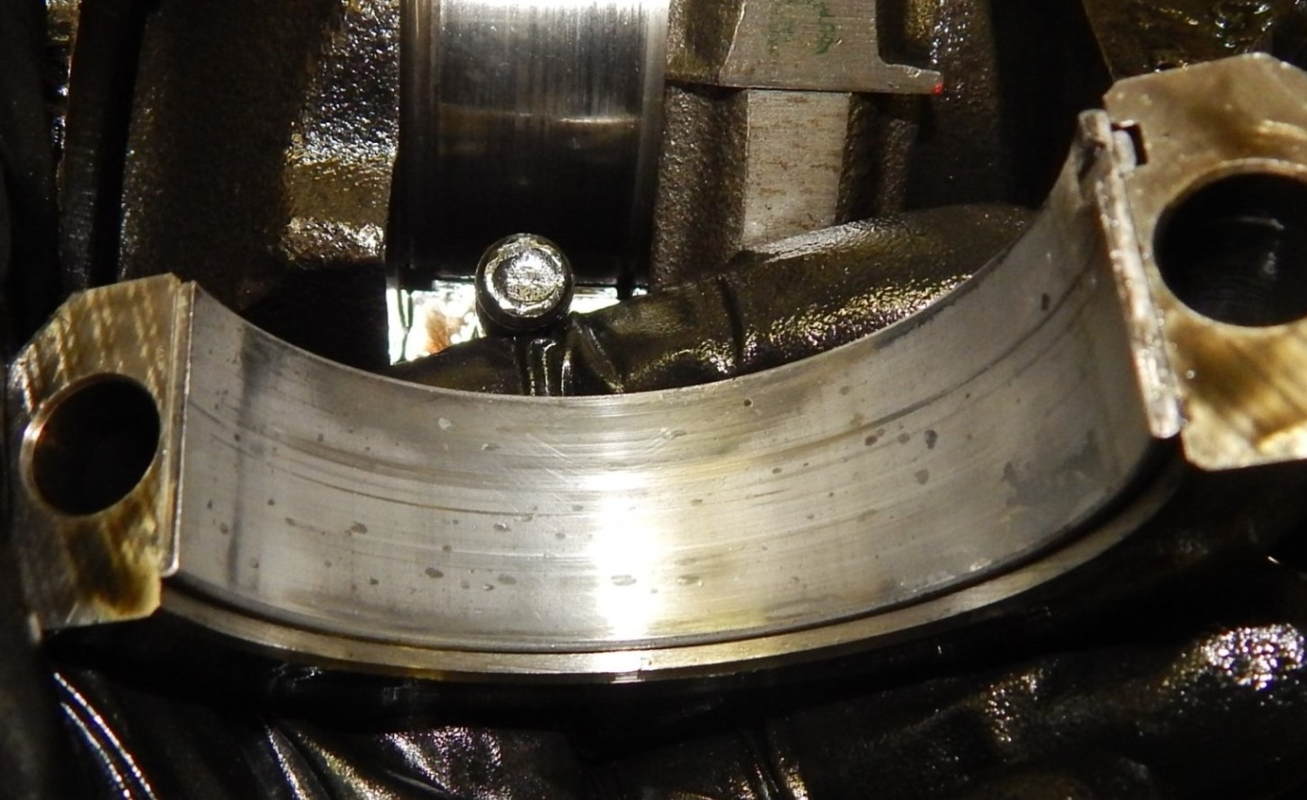

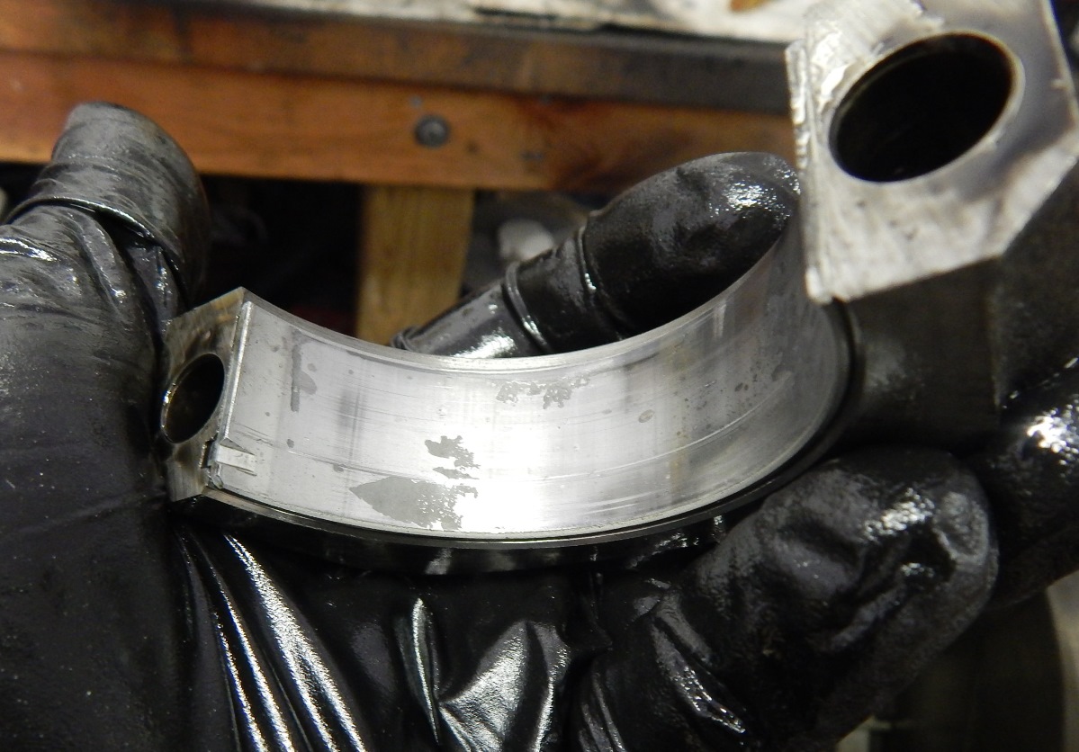

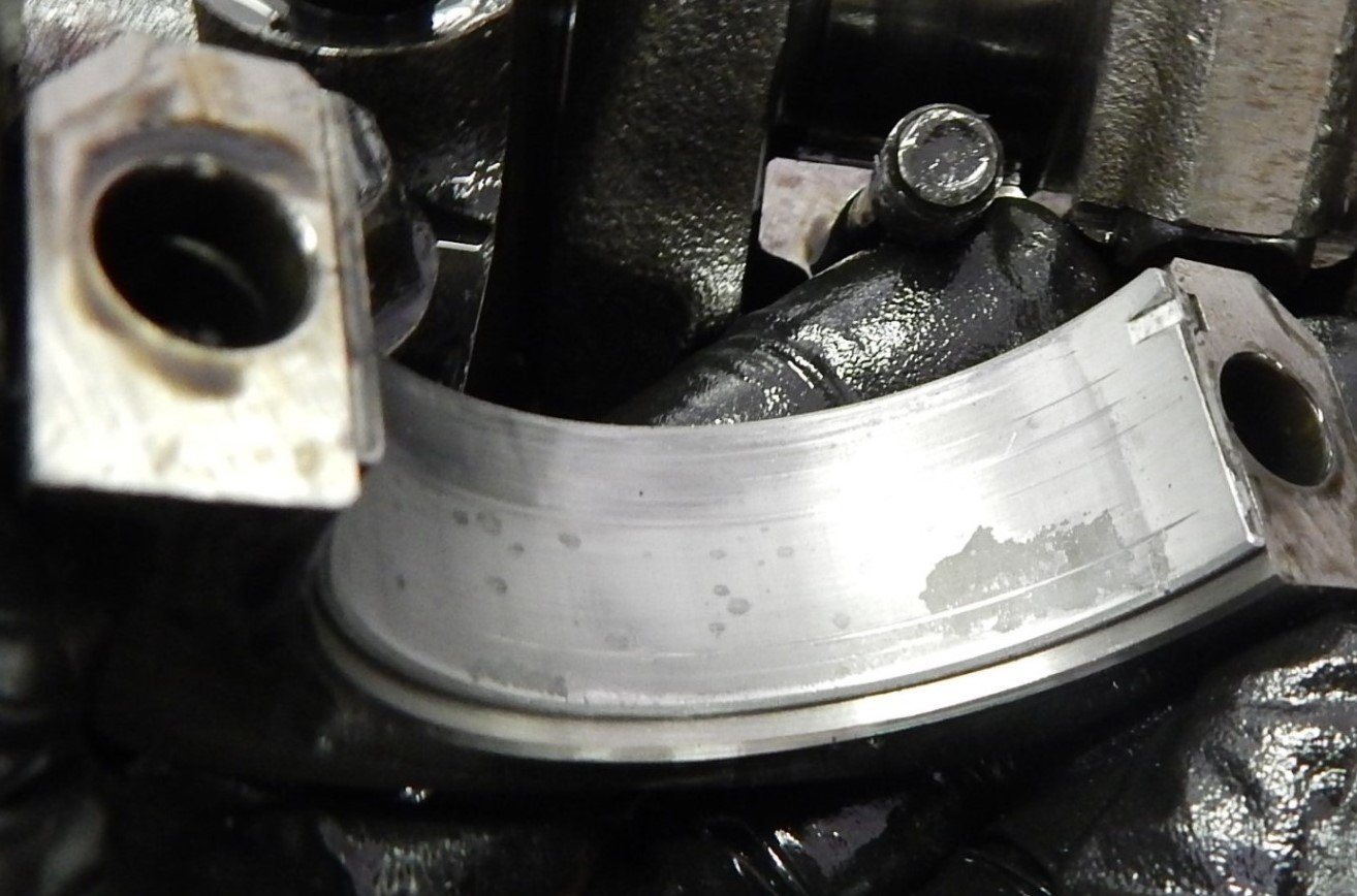

I bought this 1995 GMC K2500 diesel Suburban brand new back in the Spring of '95. You may recall the fun I had when the headgaskets blew during the MCACN trip in 2013. The headgasket replacement lasted another three years and 15,000 miles but the recent oil analysis was showing some major lead and tin values in the oil - to the tune of 17 times the maximum recommended standard. Every time I'd talk to the oil analysis techs, they kept asking if this was from a running engine or an autopsy? When I told them it was running fine they asked if it had any oil pressure and whether it was making angry, loud, unnatural noises? In fact it has been sounding the same way for the past 22 years and has never been stronger!
And you know as well as I do that a great running engine is always a bad sign that catastrophe is just around the corner. I even towed the SD455 and 24' trailer with it last weekend and it ran flawlessly.
So obviously it was time to go big or stay home.
Here's the oil analysis:

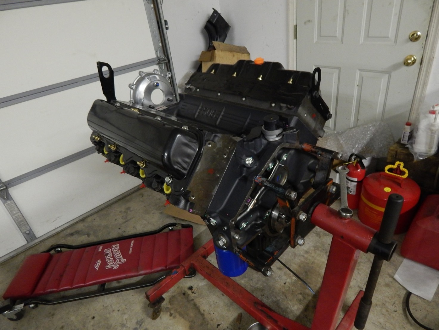

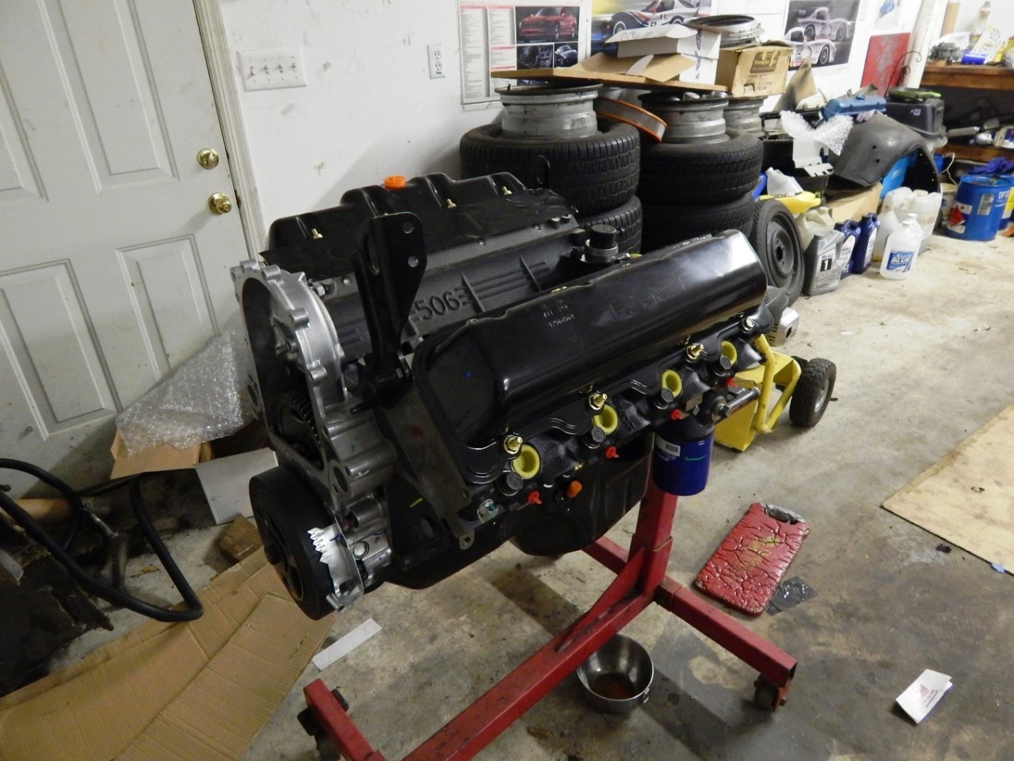

And here's the new engine. All 875 lbs on the stand.

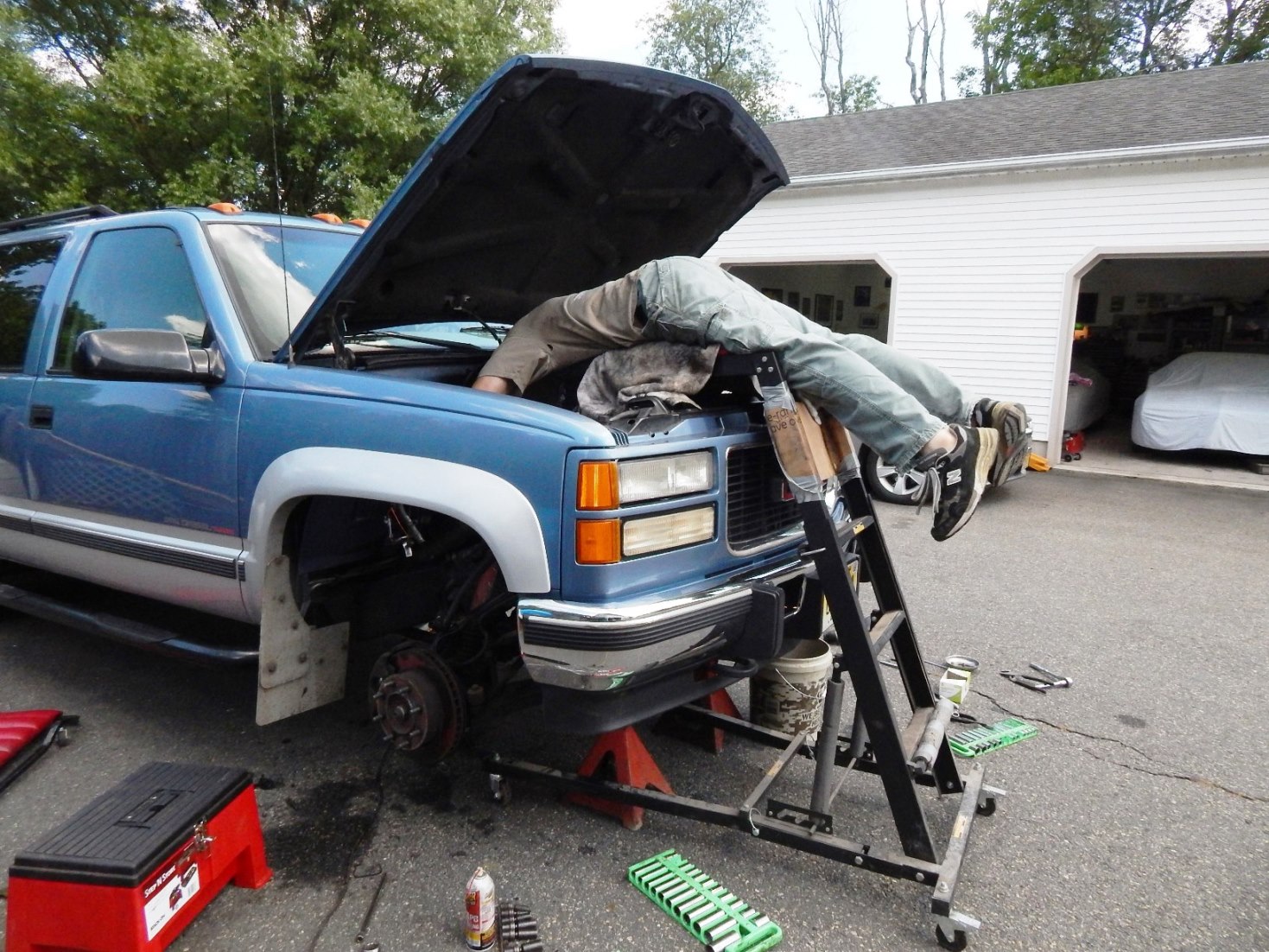

Oh, the joys of getting those last two upper bellhousing to engine bolts. There is no easy way to do it. They are double studs with all sorts of brackets coming off the studs. And not accessible from under the truck. I had to rip the remainder of the inch-thick, sound deadener pads (probably made of asbestos) off the firewall to even see the studs. That, of course is after I pulled the intake manifold, fuel/water separator, assorted non-moveable wiring harnesses, etc,. Luckily I borrowed my friend's ladder-creeper - a real life saver! I used a ratcheting, angled, closed end, 1/2" wrench for the nuts and 9/16" for the studs. - yeah this is a 1995 so they used SAE threaded transmission-to-engine bolts. Everything else on the engine is metric.
