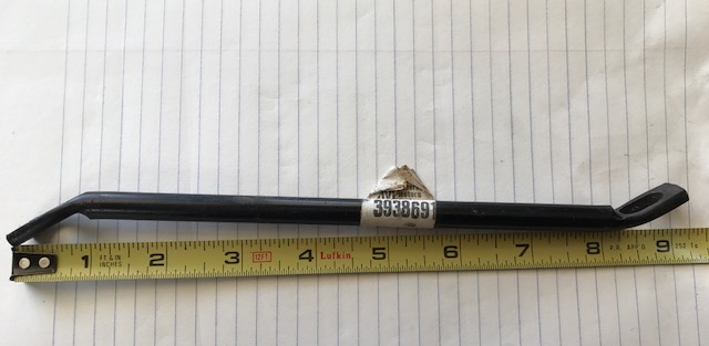

Could somebody please tell me the length of the outer front spoiler brackets for a 1969? And then for the 1968? Thank you, Joe

The 69s are around 9 inches

Here is a NOS 3938691 which I believe is 69 outer. It is exactly 9".
