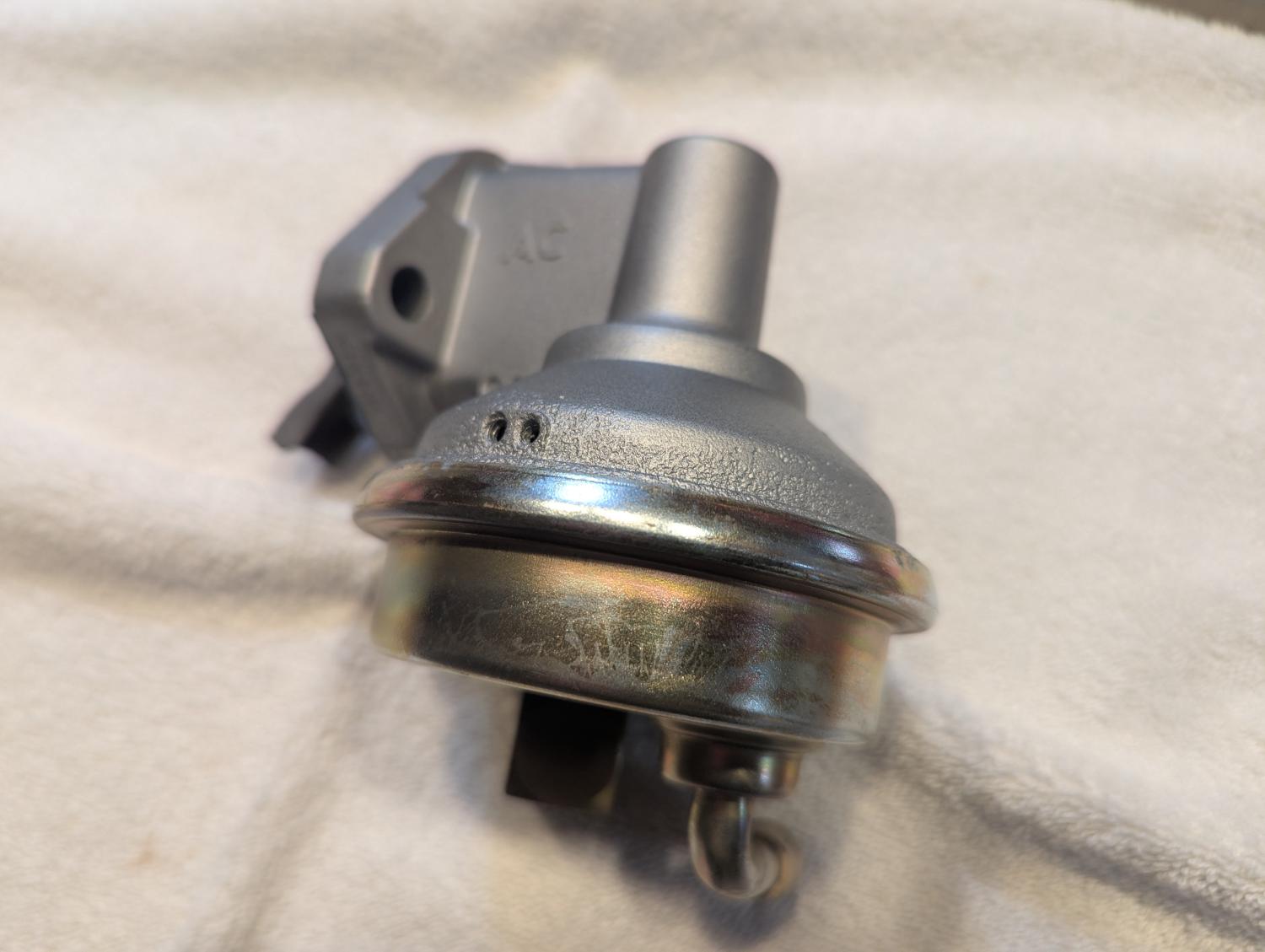

Old 06-05-2025, 04:38 AM
Posts: 2,782
Thanks: 148
Thanked 322 Times in 113 Posts
I had my GOAT HILL incorrectly plated 40726 AC Pump plated with Yellow Zinc on the Steel Fuel Section...............
Now Im asking for a conclusion on how best to refinish the cast Aluminum Portion....
Glass Bead and Spray with Clear ???
OR What's Your "Secret"
Bottom Pic is Service Replacement that Id like to replicate the "LOOK"
Chuck Sharin
[email protected]
70 Camaro R/S Z-28, L-78
69 Camaro COPO recreation

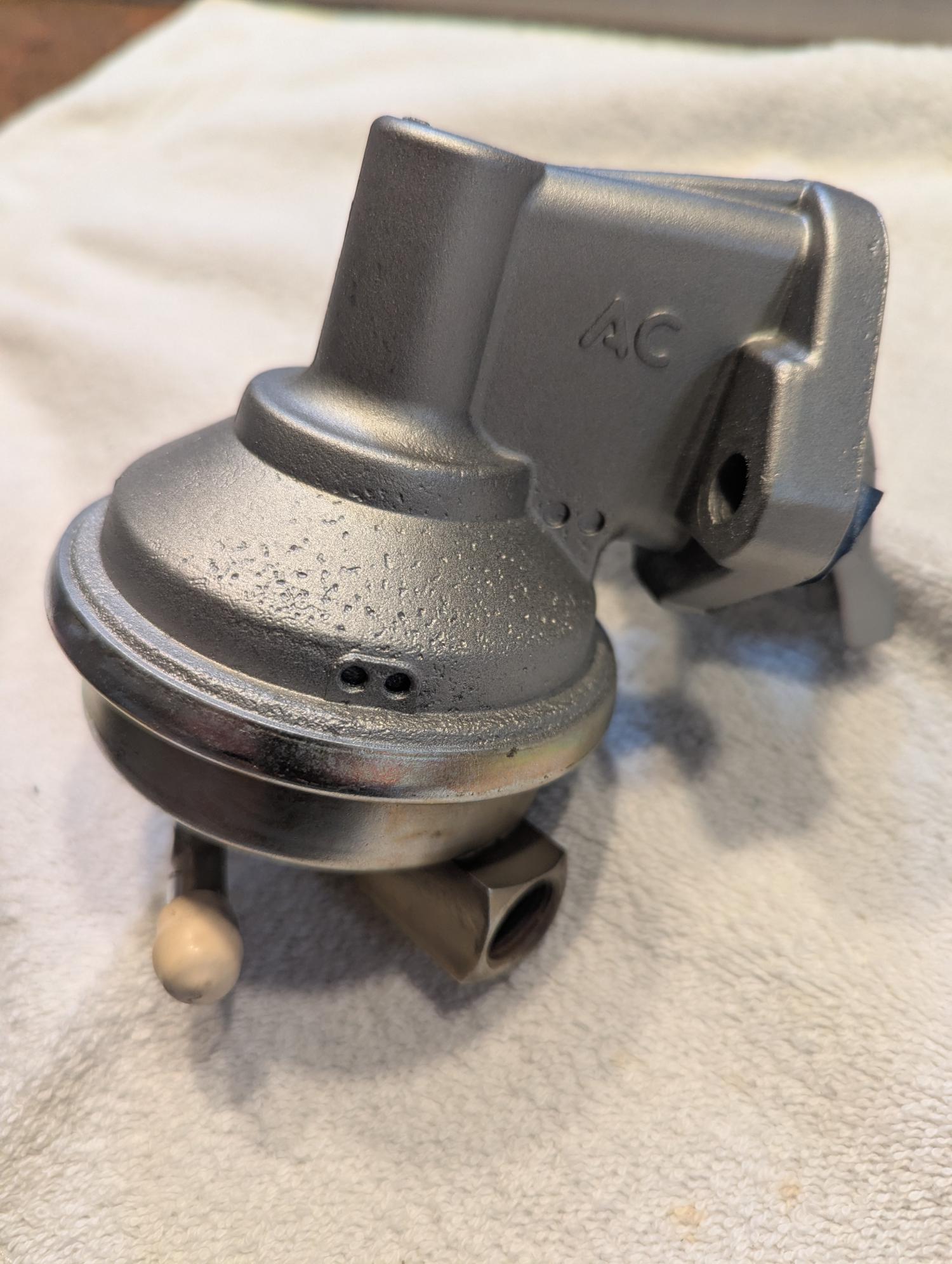

Old 06-12-2025, 04:38 AM
Posts: 2,782
Thanks: 148
On the above pictured pump , I glassbeaded the cast aluminum "top" section so its
clean but I dont like the look.........
I dont have a can of Eastwood/Seymour AlumiBlast .....Any thoughts on
what aeresol I could mist on the glassbeaed aluminum to make it look
"good"
This pump cosmetic restoration has turned into a ugly project.........but
I'd still like to have the date coded pump on my 70 Z28 .............
Chuck Sharin
[email protected]
