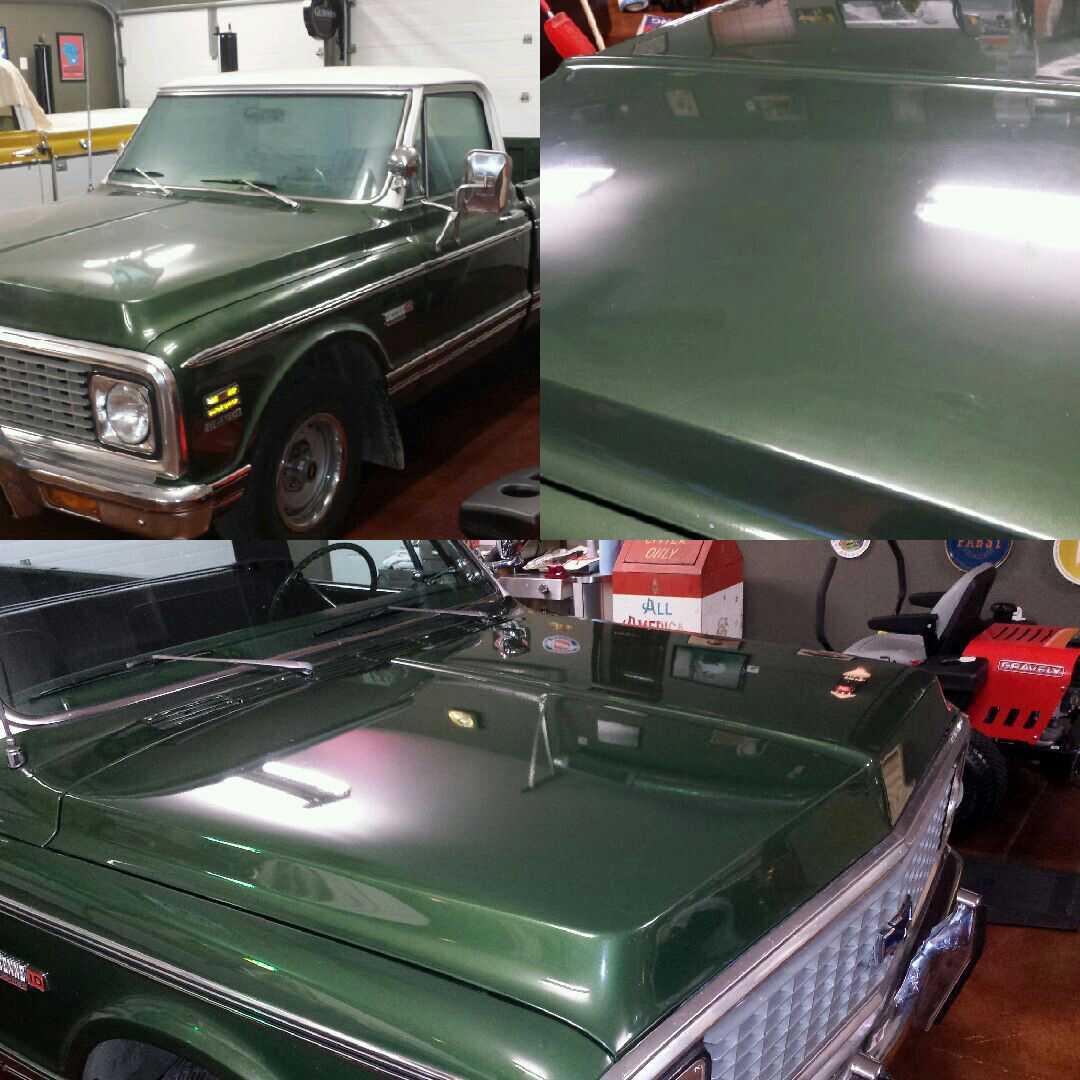

I typically follow the #7 treatment with Meguiars 205 and a foam pad at around 1000 rpm on the orbital buffwr and topping with a carnauba wax. Here's a quick before and after of an original paint '71 C10 I used this technique with. If your paint has gloss and oils from your previous coats of #7, you might be be able to just machine polish and wax.
Jeff
Jeff
Jeff, wonderful results.

Guys, I can't tell you how much i appreciate the compliments. There's nothing I enjoy more in our hobby than bringing original, faded paint back to life. I hope the OP has great results, too!

----What did you do with the holes with the 4 holes below the antenna?......Bill S

I ended up just leaving them. If you zoom on the 2nd photo, they're still there. I think they were for camper stabilizers at some point?
