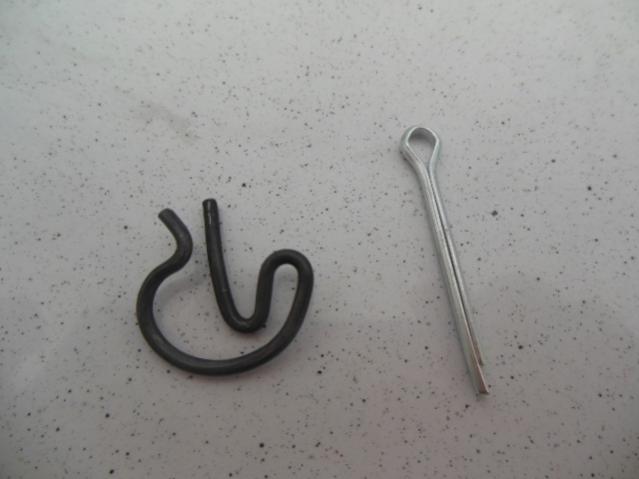

On 1969 s/b hurst linkage what is correct to hold linkage rod to shifter & side cover arm to the rod
That would be the clip on the left.

Ok thanks just wondering way the factory asembly manuel shows cotter pins ?
I was gonna reply but was not sure, did some have cotter pins on the shifter.
I know for a fact that aftermarket CompPlus Hurst shifters (example) came with the clips shown on the left -- they did not use cotter pins. The clips can be a pain in the south-end to install and sometimes go a-flyin' -- that's why there are Hurst shifters out there with cotter pins ... and they rattle like an SOB ... TAZ

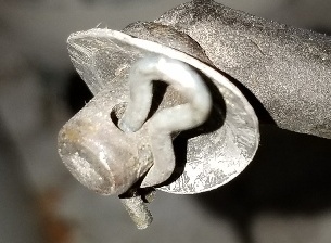

Original were cotter pin and wave washer. I'm not referring to after market Hurst.
Steve Shauger The Supercar Registry www.yenko.net or www.thesupercarregistry.com Vintage Certification™ , Providing Recognition to Unrestored Muscle Cars. Website: www.vintagecertification.com |
Must be before the late 60s ... every aftermarket Hurst I have seen/installed had the clips ... TAZ
You've never lived until you've almost died -- for those who fight for it, life has a flavor the protected will never know! |
Thats correct i am working with a factory installed hurst 4 speed shifter not a after market unit
The factory shifters and trans levers also incorporated rubber grommets at the rod connections to minimize noise. Aftermarket shifters used bushings and clips.
