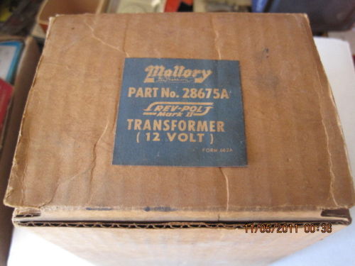

Sam, I didn't want to let this out yet, but I have an NOS YC-310-HP. Not any cheaper than the new ones. Dated Aug 71. I also have an NOS Mallory CDNA-1 on it's way. Dated 69. I wanted to know what coil can be used with this combo? I almost had an NOS 28675 coil.
