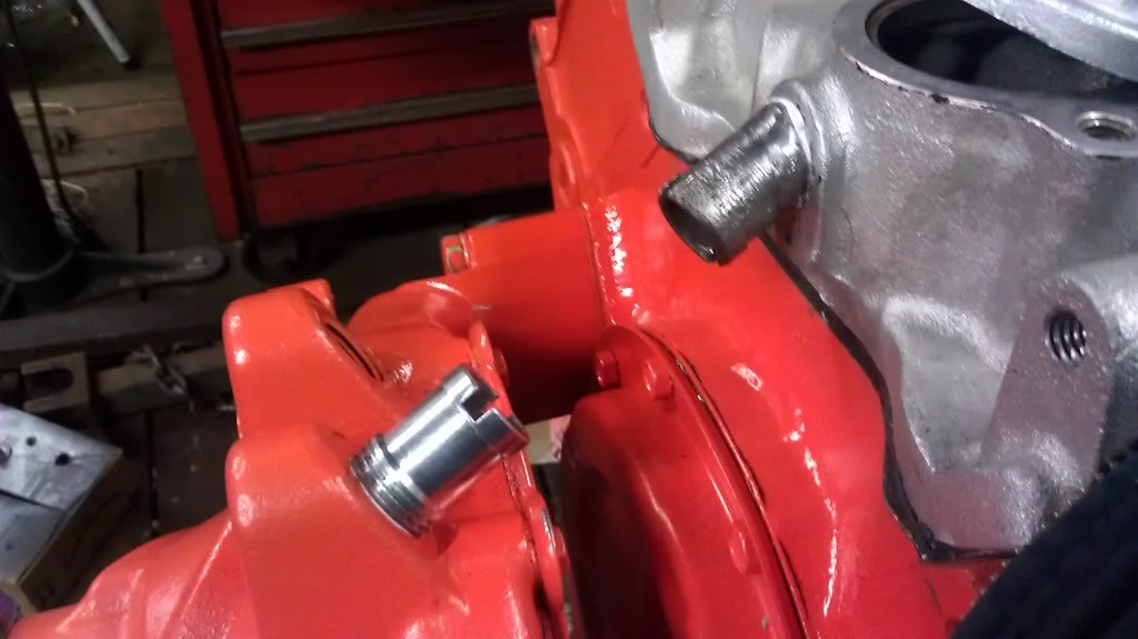

Is there any kind of special tool made for removal and/or installation of the water pump bypass hose fitting in a big block Chevy? This fitting has a slot in the one end, and I'm sure many (if not most)of these fittings have had a large screwdriver used for installation.....but the potential for damage or distortion of the fitting end would seem to make this a less-than-ideal choice.
Trying to remove an old one from a water pump that has been used for years is 'mission impossible' with a big screwdriver. A huge vise-Grip or ChannelLock pliers would undoubtedly work, but would also destroy the fitting. Any suggestions?

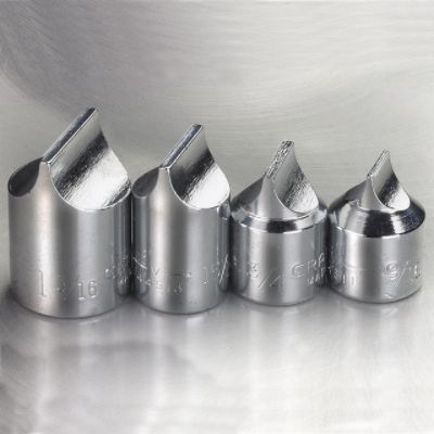

If you have an old socket you'd sacrifice, find one that is a close fit around the fitting, cut two slots in it, then place a flat piece of steel in the slots that fits into the notches in the hose fitting.

There were several socket to adjust the tie rod ends on early Chevrolets, probably other cars also. I bought some on e-bay for cheap...Joe

X-2 I use a &quot;Drag Link Adjusting Socket&quot; for heavy duty trucks.

Big Block Bill,
That looks like exactly what I need.....checking into one on eBay right now!
