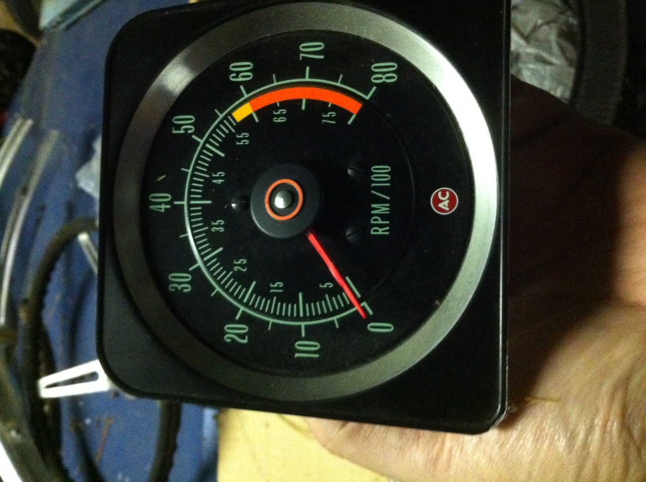

Is this the correct tach for a late production Z28/L78/L72 car?
When was the change date from the 6K/7K tachs?
Thank you in advance for your replies.

6,000 - 8,000 is 'mid to late' (from http://www.camaros.org/interior.shtml#69Z28Tach).
Not sure when the change in upper rpm redline from 7,000 to 8,000 occurred, but I have Jan/Feb in mind.

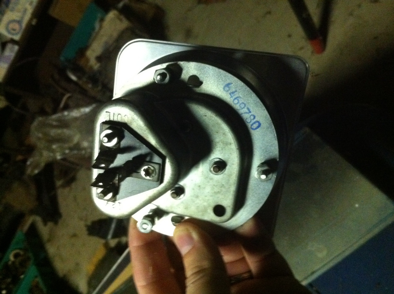

AFAIK, the 6k/8k tach was also used on the solid lifter BB engines as well as the Z/28. I looked up the number on the rear of your tach and the February 1969 P&A Catalog lists 6469780 under 9.750 Tachometer Assembly as:
'69 CAMARO w/console gauges, speed warning (302)'
So, if I read that correctly, the tach you pictured is Z/28-specific, although I believe that the original assembly would have included the harness, filter etc, so the difference between it (6469780) and the non-speed warning Z/28 and L78 version (6469383) may lie there, the assembly, rather than in the tach head itself.......

The 8000 rpm tach was Z/28 only and entered production early February 1969. It was phased in; at the time some cars were built with the 6000/7000 rpm tach. A very few later production Z/28s had an 8000 rpm tach with a 6500 rpm red line.
Mechanical lifter big blocks used the 6000/7000 rpm tach.
