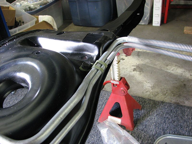

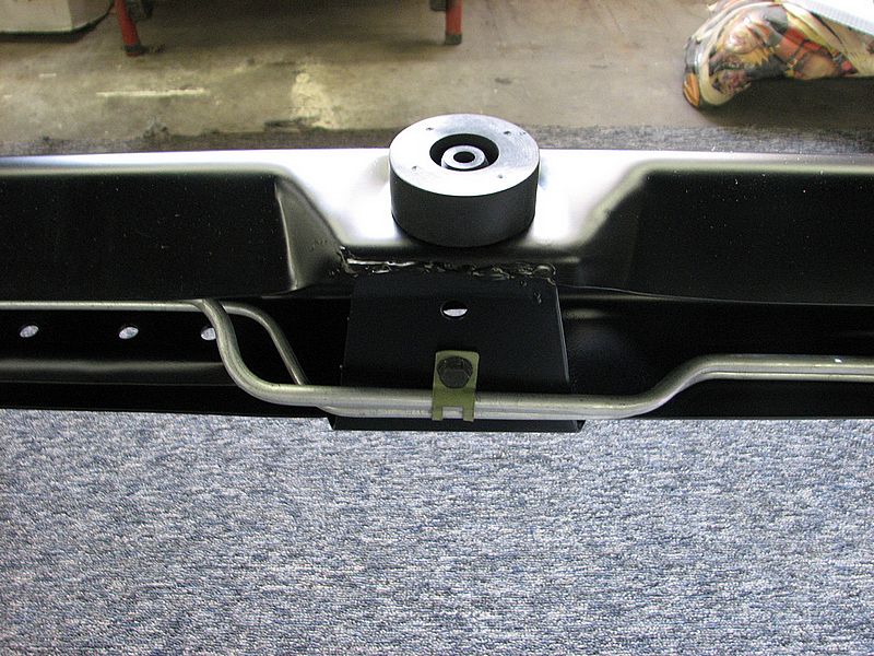

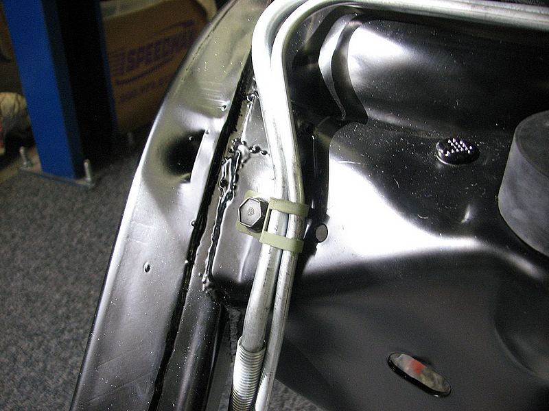

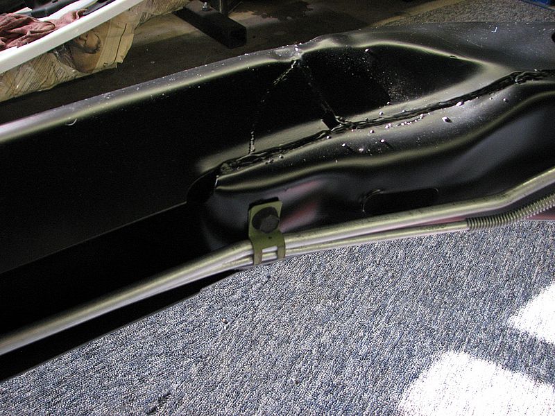

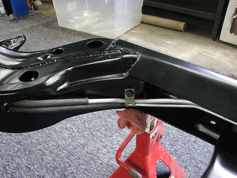

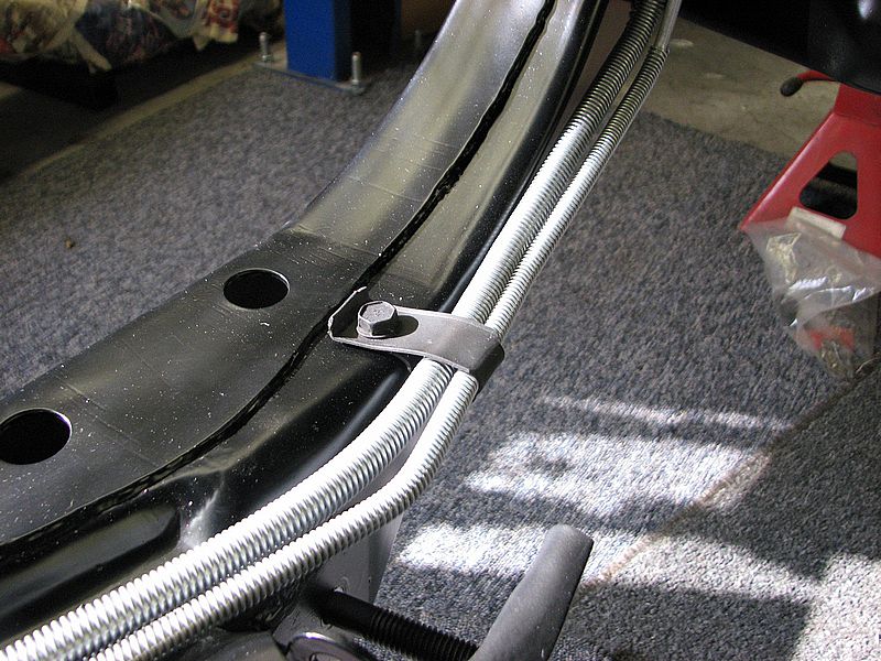

Whats the finish on the fuel line clips for a 69 Chevelle 396 350 hp

I can only speak with certainty on 1970 Baltimore built Chevelles with dual lines and they were all green with the exception of the bracket that holds them down near the rear lower trailing arm front mount. This bracket was grey phosphate. Single fuel line cars had blue clips but I think all 396's had dual fuel line. The green is a dull olive drab in color.
