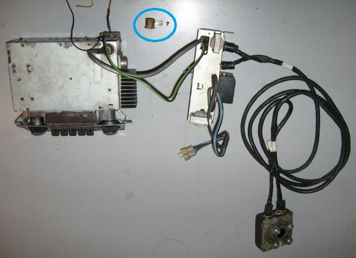

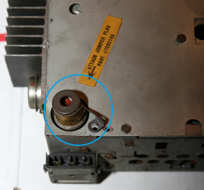

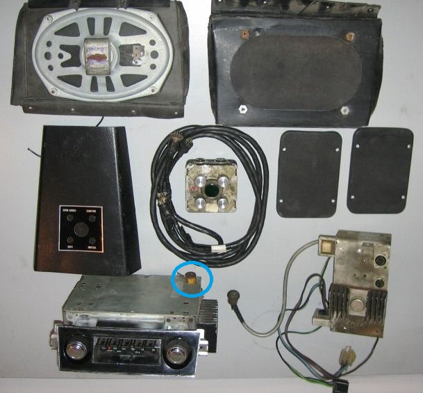

I have this Multiplex 9 Pin part in the Blue Circles.
What is it called and what is the value for something like this?

Now I get it, this has a part to make the Radio work without the Multiplex Option in a mono tone. If you ordered the Multiplex radio this would have to come off in order for the Multiplex AM/FM to work in Stereo. Thanks P.J.

I call it the multiplex eliminator plug. It plugs into the radio and makes it work as a mono radio. The radio will not work without this plug or a multiplex installed. They came on all Chevy AM/FM radios except Corvette from 1965-1969. $75-$100 would be fair for a tested working one.

Jason I was told 1965 and 1966 had a 12 pin MPX Eliminator and they started using this 9 pin plug for 1967 to 1969 Chevrolet Except Corvette.

also called a radio shunt

Appears to be a fancy name for a &quot;jumper&quot; ...

Yes, 67 and earlier radios use a 12 pin plug but I believe they use this same jumper.
