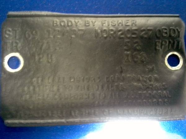

Old 08-21-2015, 02:14 PM
Posts: 21,070
Thanked 3,902 Times in 1,541 Posts
Default Re: 1969 Camaro Trim tags look out for
<span style="font-style: italic">We have smoothed the firewall for a pro-touring build so the trim tag has no use to us. If you are missing your Super Sport trim tag or building a SS396 tribute care here is the finishing touch. 785-207-0830</span>
X66 SS396
12437 V8 Coupe
NOR205270 Norwood Plant
52PNT Garnet Red Paint
712 Black Custom Bucket Interior
12B Build Date 2nd Week of December
$300.00 obo
<div class="ubbcode-block"><div class="ubbcode-header">Originally Posted By: Mr70</div><div class="ubbcode-body"><span style="font-style: italic">We have smoothed the firewall for a pro-touring build so the trim tag has no use to us. If you are missing your Super Sport trim tag or building a SS396 tribute care here is the finishing touch. 785-207-0830</span>
X66 SS396
12437 V8 Coupe
$300.00 obo</div></div>
This is an original tag.
www.vintagecertification.com
