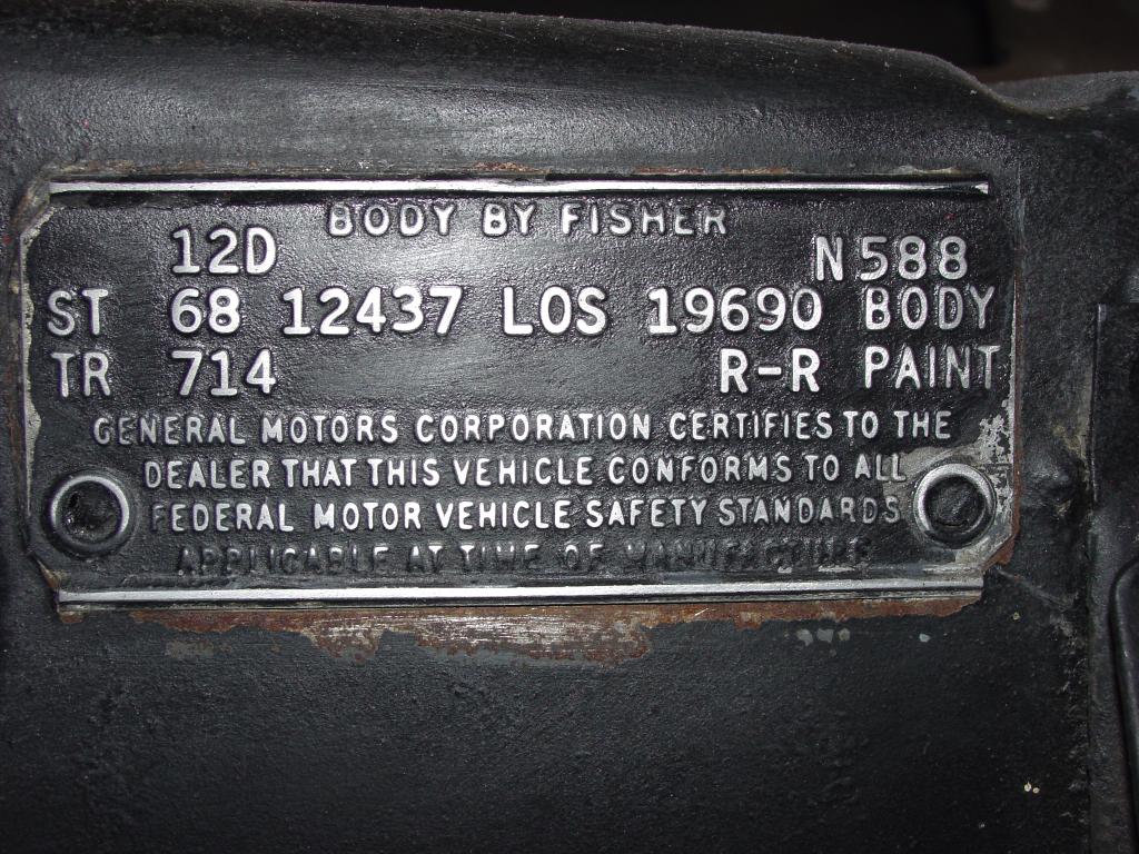

12D Build car and according to NCRS finish date of 12-22-1967 and it has 302 emblems. He is incorrect on his thinking. Just my $0.02
