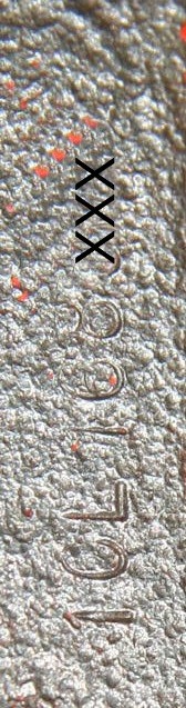

I looked at a LS6 engine today the casting date was J249, the build date was TO618 no vin one head was early may of 70 the other was late april 70. Did any one ever see a casting and build date so far apart

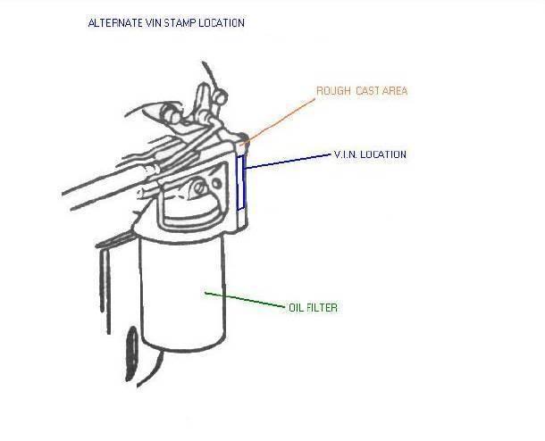

Did you check the pad near the oil filter boss to see if there was a Vin number there? 1970 Van Nuys would stamp the partial VIN on the rough cast area by the oil filter. see photo
Also I'm not real surprised by the date spread you have as this happened once in awhile with blocks sitting at the back of the batch of the newer made blocks, it was not common but it did happen as there are a few survivors documented with longer spread dates than others [img]<<GRAEMLIN_URL>>/biggthumpup.gif[/img]

nothing by the oil filter either
