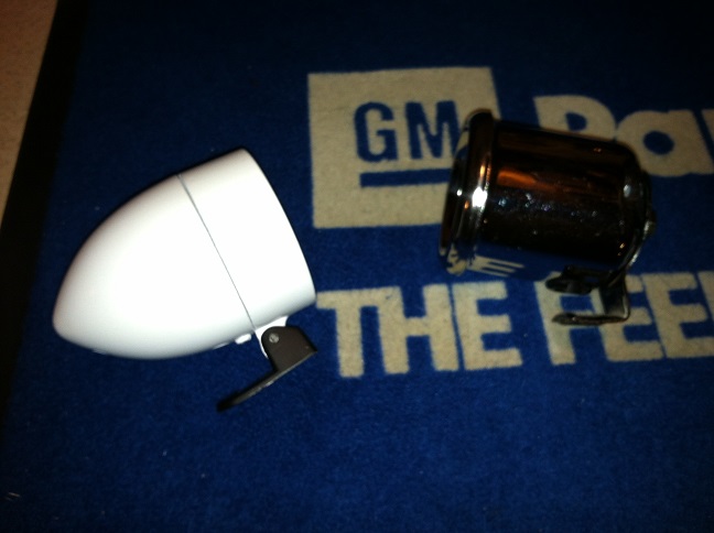

I have a 1978 Camaro. How did you guys mount the fuel pressure gauge to the cowl back in the day? I do not want to mount the gauge inside with a isolator and I am still running the stock hood. I have seen some pictures with some sort of mount for the pressure gauge but the hoods are shut and the picture's are taken from a distance.

It looks like what I am looking for is the same mount that was used on grumpys toy 8. Every picture I have found either has something in the way and I can not see the mount. If I could see how they mounted the fuel pressure gauge I could make something up from scratch.

I used the material glass installers use to set the old flat glass into the channels as a nice and neatly trimmed base, then took my time by going between the ribs on the cowl. PERFECT.
