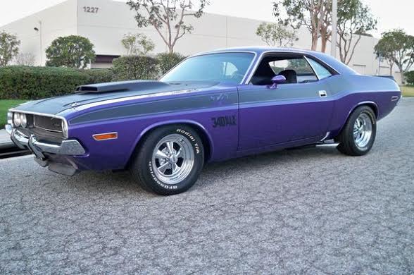

After getting advise from a few guys here on SYC, I decided to go with Cragars. I wanted cheater slicks for that day 2 look. I went with 14 x 7's on the back, and 15 x 6's up front. The back tires fit up inside the wheelwell with no rubbing. If you go with 8&quot; wheels get the back spacing right as stated above. I also got the tow tabs as suggested.
Here's a shot with the Cragars, and below in my sig picture is a shot with the 15&quot; SS wheels, with G-70-15's (all 4)
