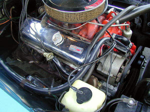

I've observed a dark bronze finish on many original cars, although as Mark stated they were supposed to be black. It will be interesting to see what Steve Gregori's finish looks like. Below is an example of the brown finish on an original RH-BB smog tube.
www.vintagecertification.com

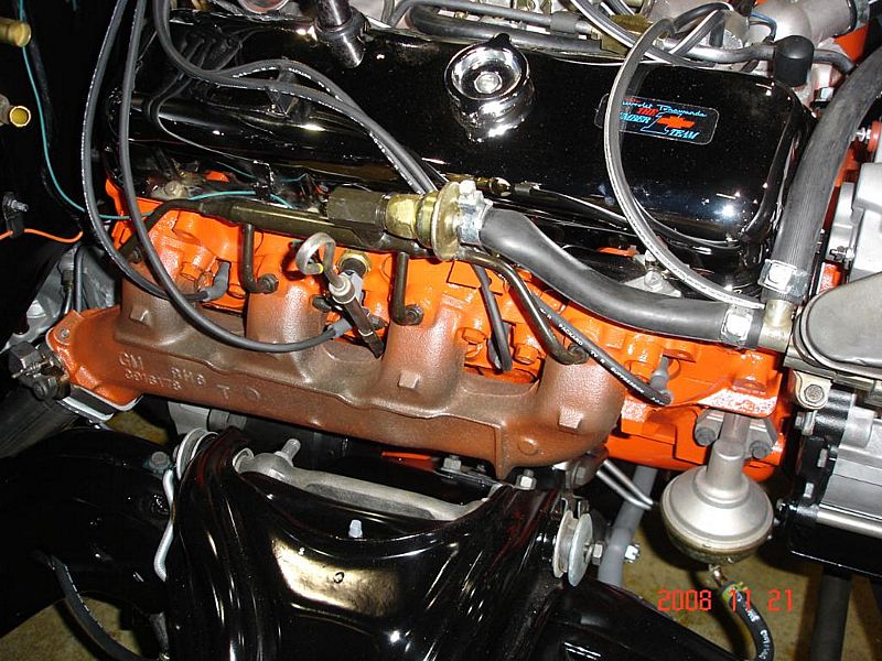

Here is another photo of what the coloration should look like. These were NOS.

rick, that looks like a brown green color?

Thanked 4,925 Times in 1,200 Posts
Default Re: smog tubes plating
Yes

which would be the olive drab finish I believe?
