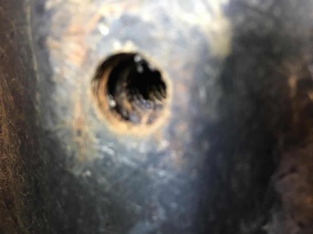

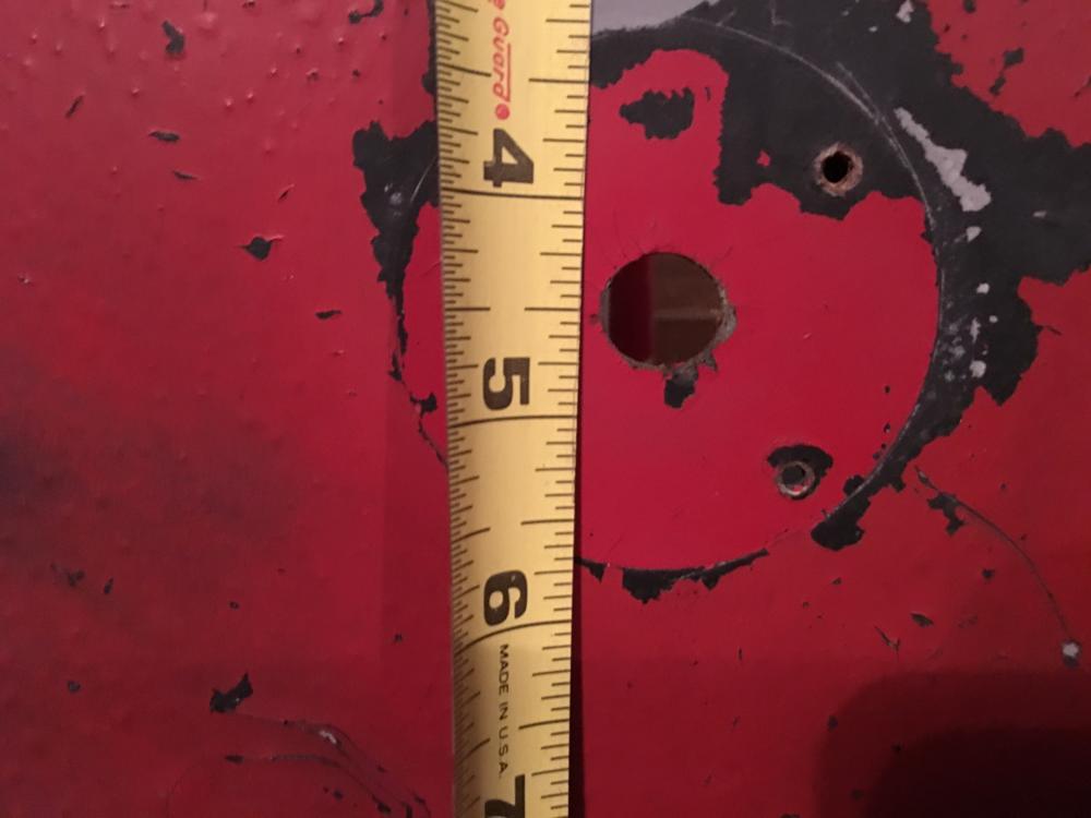

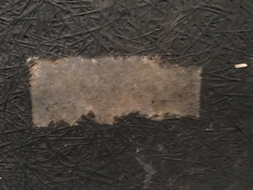

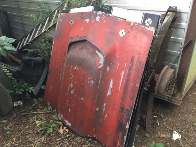

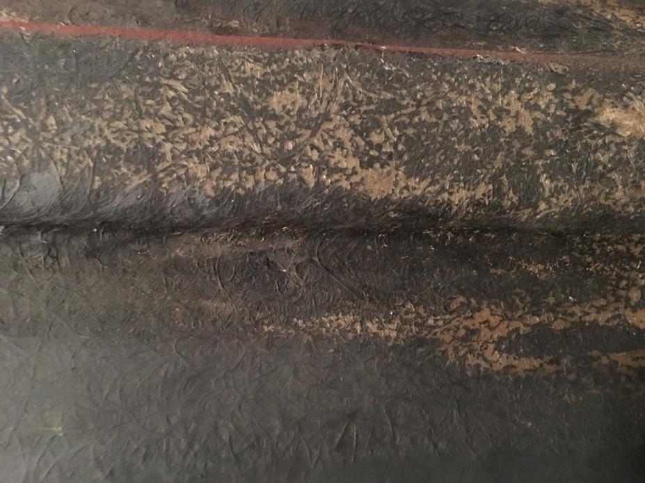

Ive posted pics in the past of the hood I have and I am curious of its origin. It has the molded holes for the pins and has the steel inserts molded in the glass. One has actually come loose and Im pretty sure that is what damage the hood. I am working on getting it fixed, painted and will hopefully be installing it on the 67 with the fly eye air cleaner.. I can see what looks like a yellowish white finish on the underside below the black paint.. Pretty sure its not an original Motion hood but definitely old..

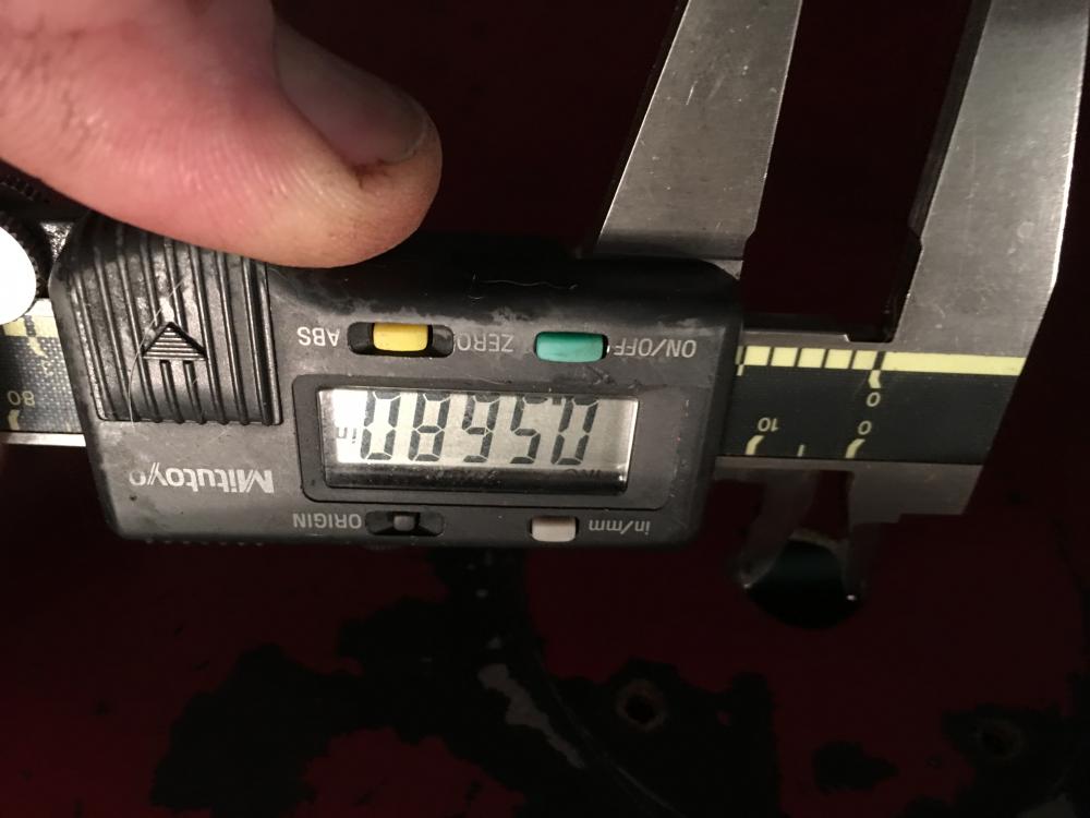

Location on this car (granted not the L88 hood are at the bumpers.. This hood of mine are further inboard. First 2 measurements are the passenger side hole and the other 2 are driver side, followed by the hole dia.
