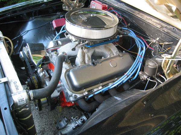

I am buying a 540 big block for my 1969 SS RS 396 Camaro and it has roller rockers. Is there a tall valve cover available that will work with this motor combination and the original disc brake power booster?

Does that 540 have regular stud-mounted roller rockers or a shaft mounted system? My 540 had a Jesel shaft rocker set-up which requires even more inner clearance along the intake rockers. If this would be your case then the sheetmetal Moroso's will work or those cool GM Performance Parts cast aluminum valve covers will work. If you have regular stud-mounted roller rockers, I would look into a regular tall valve cover and a smaller power booster. Better yet, I'd change it over to manual brakes and be done with it. I believe that it's either Stainless Steel Brakes Corp. or Master Power that offers a maunual disc/drum master cylinder. If this 540 has the camshaft that it needs to breath, it's not going to have enough vacuum anyway for power brakes. Also on those early Camaro's that wiper motor can be a problem. Detroit Speed and Engineering sells a more compact one to solve clearance issues.

I ran Harland-Sharp 1.8 rollers on my old AFR heads with stock valve covers and everything cleared fine. Not sure if it would clear a brake booster relief though.

Some of the "stock appearing" big block drag cars are running Jessel Shaft Systems with stock covers and a couple of extra gaskets. Gotta remove the drippers and shorten the adjusters a little bit, but tall covers aren't necessary even with .700+ lift.

Try a set of aluminum adapters or spacers that go between the valve covers and the head.I used a set on mine and it worked for me.As a matter of fact they are hanging on the wall now somewhere .I sold that engine and went with a different setup in that car.
