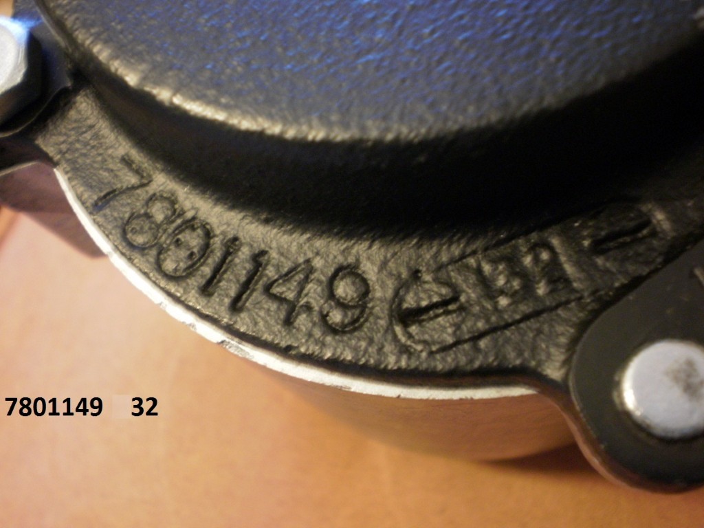

Here is the LS6 Smog with Exhaust manifolds Restored and ready to go.
Some numbers i can't figure out?
Also let me know if these are all correct smog parts for the LS6 (Pretty sure they are but i just want to confirm).
All the smog hoses and clamps are the originals.
The picture of the Exhauast shows i grinded off the flap, Drilled a small hole and added a cotter pin to keep the side of the bar from sliding, I figured why bother having the heat riser with the flap if the car never gets used on cold days!
The Exhaust heat riser will still operate but with no Flap in the damn way (free flow all the time).

Here is the Smog Pulley

Do you need a white SMOG fan?
Your SMOG Pump shows an assembly date of March 19th,1970.
I know you said you have an April 23rd car,but what's your engines' assembly date?

<div class="ubbcode-block"><div class="ubbcode-header">Originally Posted By: Mr70</div><div class="ubbcode-body">Do you need a white SMOG fan?
I know you said you have an April 23rd car,but what's your engines' assembly date? </div></div>
The Fan is white underneath the Pulley, Is that the fan you are talking about? if so i do not need it.
Can you tell me were you got the March 19th date From the smog?
(Which Photo)
Engine assembly date is March 26 On the front of the block and March 5 Casting at the rear of the block.

Yeah..that's the fan.
March 19th comes from your 07801S code on the machined pad.
