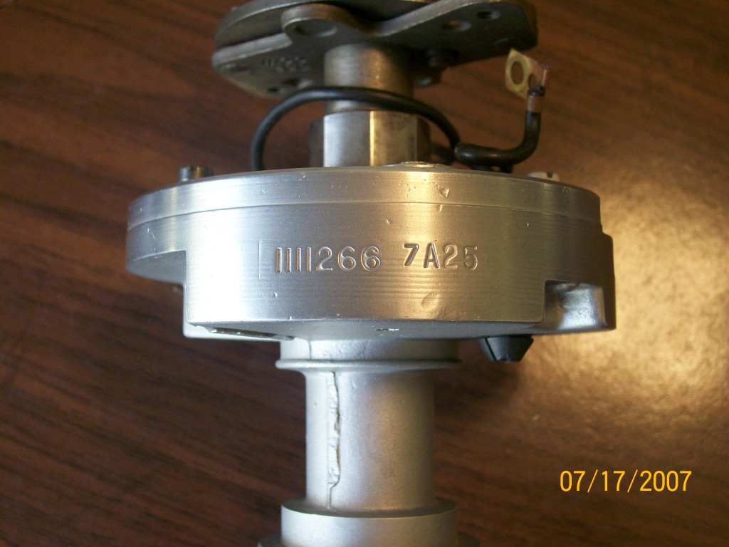

Not real...wrong cam and it is a restamp.

Here is a real stamp.
