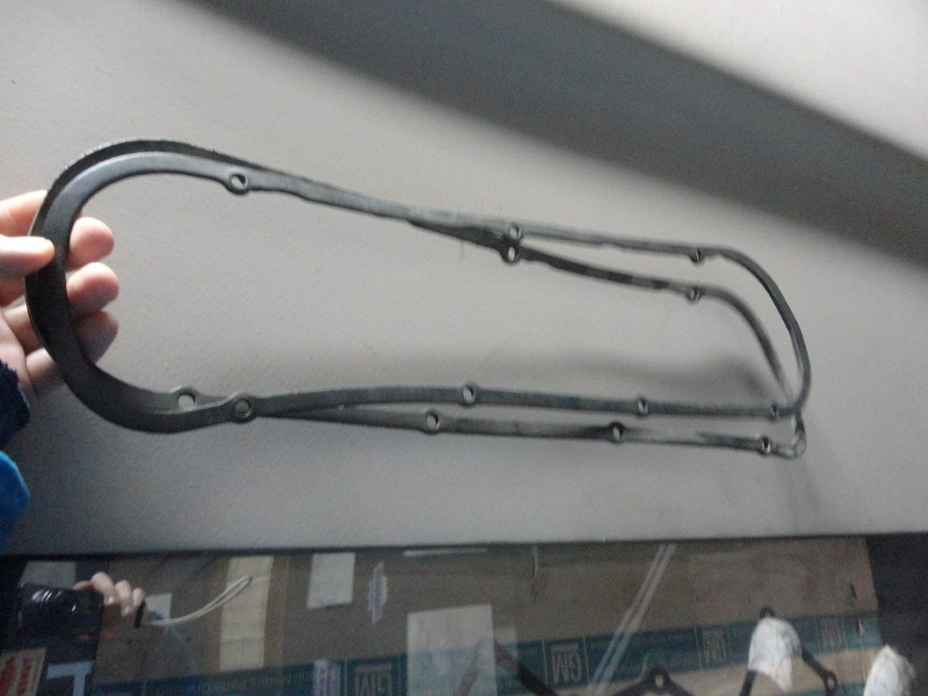

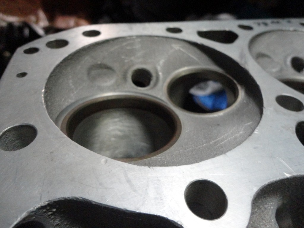

A friend of mine (Boomer) took these pictures of a 1969 Smokey Yunick 302 Hemi Z28 at the Street Machine Nationals in St. Paul, MN.

I'll bet those intake gaskets are hard to come by.....
Verne [img]<<GRAEMLIN_URL>>/wink.gif[/img]

Hi... just because someone (or a website or two) claims they are &quot;hemi heads&quot;, I wouldn't be too quick to believe it. I suspect if you saw the combustion chambers on those so-called &quot;hemi&quot; heads you'd change your mind pretty quickly...L-O-L.
Keep in mind that: A hemi generally needs a central plug location. A hemi needs a large bulky rocker arm assembly. The valve cover would have to be very (very) wide to allow for the valve arrangement on a hemi small block head. On the other hand, Chevy pretty much had a background in Canted Valve or &quot;Semi Hemi&quot; heads in the rat motor family at the time. The canted valve design does not mandate a central plug location nor does it mandate a convoluted rocker arm arrangement that would require a comprehensive cylinder block revision. And a canted valve setup could use a valve cover that was, for all intents and purposes shaped like a little rat motor piece. Following right along, a canted valve 90-degree V6 and then a canted valve small block head was released by GMPP years later that with revised ports looked suspiciously close to the head on the Yunick engine. I suspect if you do some additional research you'll find that this was a canted valve small block cylinder head that Yunick, Jenkins and others were playing with at the time. In fact, I think you'll discover that Jenkins even messed with them in his Vega/Monza era.
And I too discussed these heads with Smokey at length (anyone who knew him in later years will tell you he was pretty free with information).
Wayne

With all due repect to those of you out there that have spoken to Smokey himself and that are more knowledgeable than me.I respectfully disagree on two points.
First, I just looked at my heads here and they sure look like a hemi head to me....what is actually the difference in a hemi head or a semi-hemi head anyway??? the chambers are completely round and the spark plug hole is in the center of the valves and close to the center of the chamber. Maybe they are not as deep a chamber as a chrysler hemi head???
Second,....I am getting ready to build my motor to put in my 67 Z and I am planning on seeing if I can get 600 plus horses out of my heads !!!
