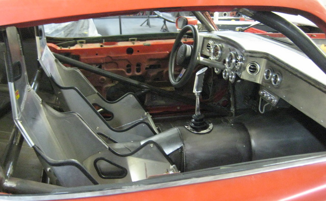

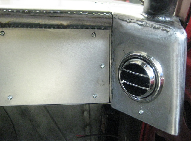

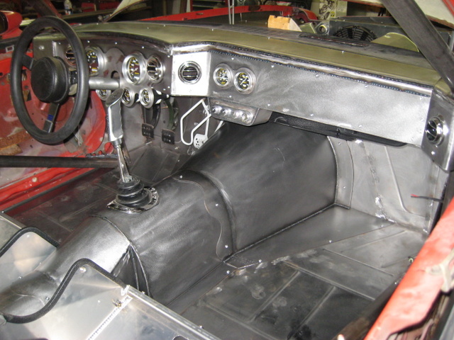

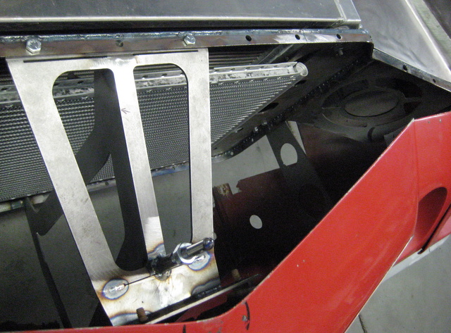

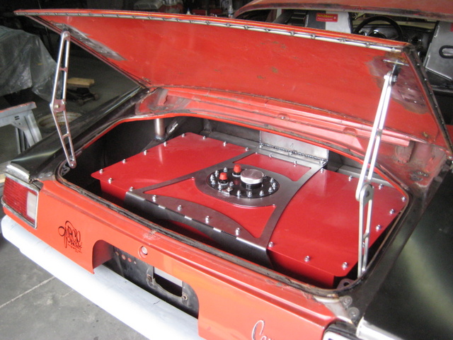

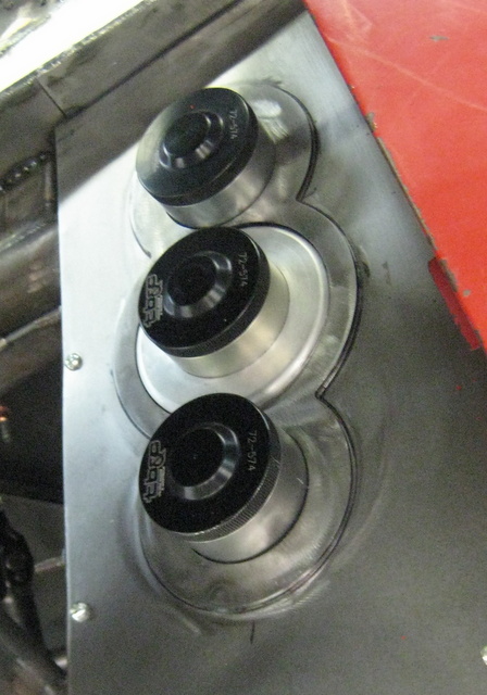

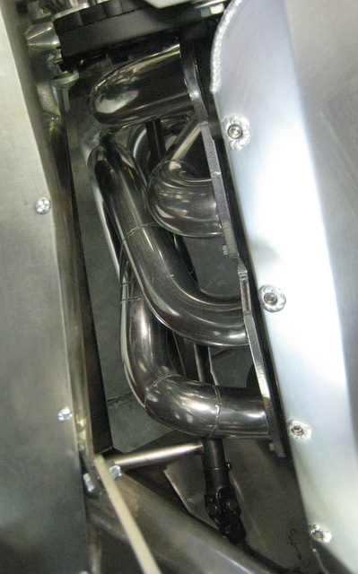

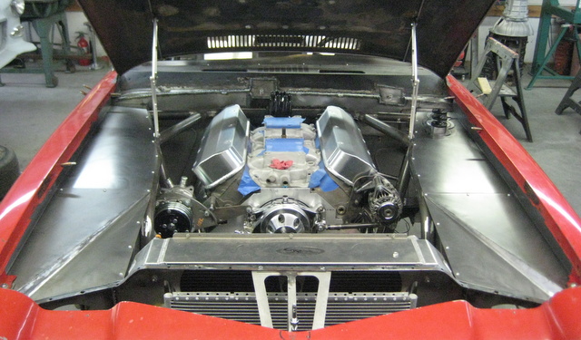

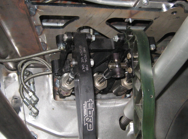

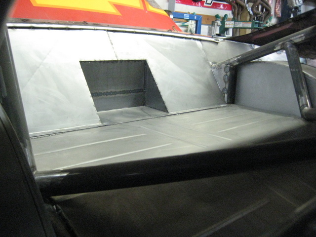

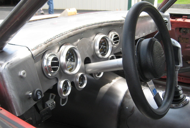

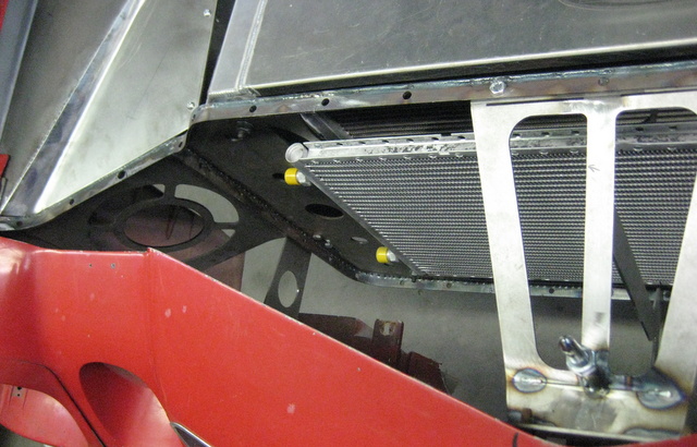

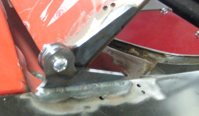

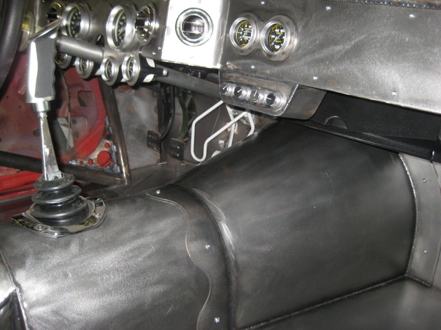

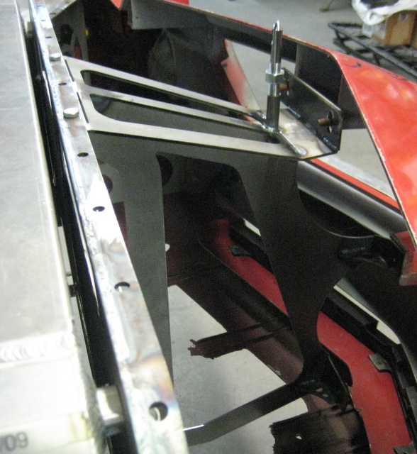

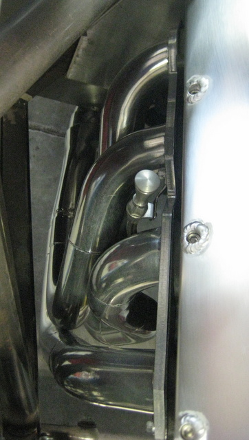

Sent this car out over the weekend. The owner bought it in 1975 and made it into a drag car. The red and yellow paint work has been on since'77. After letting the car sit for the last 10 to 15 years, he decided to put it back on the street, but decided to go the road race route this time.
468 BBC, Keisler 6-speed, Fab 9 rearend with Chassis Works 4-link and front suspension crossmember. We added Vintage Air, tilt column, adjustable pedals and custom headers and exhaust. Most of the parts on the car came from shut down Cup teams.
