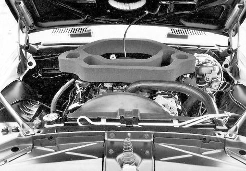

Was the power steering cooler line that ran in front of the top of the radiator an available option? or a mandatory option on certain motor packages? thanks
Attachments - The Supercar Registry 1969_Trans_Am_RAIV_-_1994_POCI_Nats2-491x341.jpg

Bottom of this Mike Noun page notes all T/A's were PS equipped w/ the PS Coolers plus all A/C Equipped '69 Firebirds got them also any Non-A/C cars w/ 3.36 or steeper gearing...
http://www.musclecarfilms.com/1969_F...ir_setups.html
