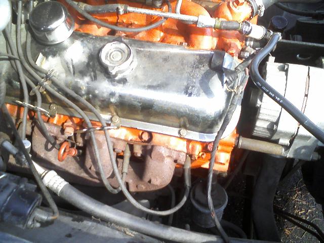

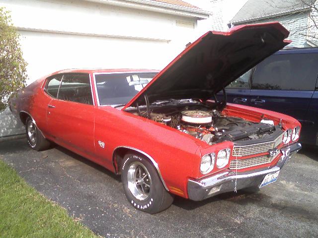

Here's a couple cell phone pics. Still haven't heard from the guy. Like I said, he was very vague about everything.

its got bias plys on it too
looks like a good oppy for you
the a/c does not look too hacked, surely a desirable option ... IMHO

That is a very early 1970,I can tell by the lower headlight trim...what is the build date?
