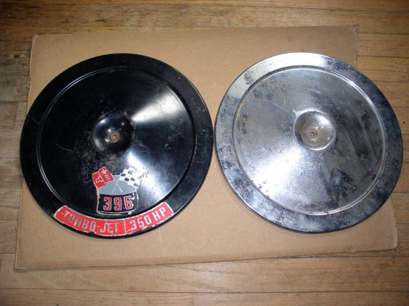

I am sorry if this is a dumb question but are the 65 Corvette 396, 69 Camaro 396 open element or with cowl induction use the same black air cleaner lid? I have a friend that is looking for one and was asked this but I did know for sure. Thanks in advance.

I believe so.

I think originally 1965-66 396 Vette & 67 396 Camaro shared the same lid be it chrome or black,part#6422356.
Then lid #6421832 came into effect and was offered on 1966-68 Corvette & Impala w/327 & 427cid.,1969 Impala w/Spcl.Hi-Perf 427cid.and 67-69 Camaro w/396 & 427cid..be it chrome or black.

Chevrolet parts catalog dated 1970 list the 6422356 and 6421832 air cleaner lids
6422356 (lid)
65-66 Corvette (396) (w/ 6421816 air cleaner)
67 Camaro (396) (w/ 6424434-35-36 air cleaner)
list price 8.70
6421832 (lid)
66-68 Pass, Corvette (327,396) (w/ 6421963-2286--7-3240-69-3520-3689-3907-8-9 air cleaner)
66-69 Chevy, Chevelle (327,396)
67-69 Camaro (396)
All (w/ 6423269 -3908-64836-56 air cleaner)
69 Pass w/ Spl Hi/Per (427)
(w/ 6423907 air cleaner)
list price 16.75
Above information shows both lids used at the same time for service replacement lids
- black lid w/ list price of $8.70
- chrome lid w/ list price of $16.75
Both lids are listed in 1974 parts catalogs also
