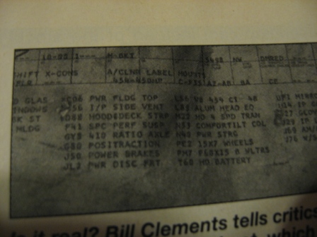

Pictured broadcast sheet says:
L89 Alum HEAD EQ
PE2 15 X 7 WHEELS (15s on a 70 SS?!)
BOX 60 LW HOOD (supposedly a ACME FABRICATING factory fiberglass cowl induction hood - he has documents)
ACME did the W30 hood for Olds
If this car has been discussed here before please direct me to the thread, if not what is this? thanks in advance.

pic 3

That LS-6 Chevelle Convertible was just that,and not an LS-6 equipped w/alumnium heads from the factory originally.
Bill Clement at ChevyCraft in Tex. was the one who owned it and made that claim at that time.The paperwork was doctored to reflect the Al. Head option,and soon disproven.
That car was orginally sold here new at Dick Wickstrom Chevrolet in Roselle,Il.back during 1970.
I don't believe any 1970 LS-6 Chevelle was assembled w/L-89 Al.Heads from the factory.

According to a conversation I had with Fran Preeve a while back, Tonowanda NEVER produced an L89 LS6 for production or over the counter use nor were they ever any codes assigned to any such configuration.
