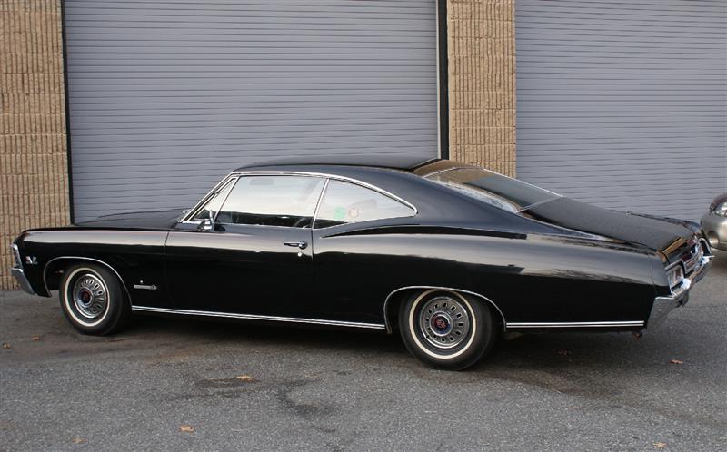

Hey all;
What were the available wheel and tire packages for an Impala SS in 67? I like the way the car looks with the original stuff, but I am pondering a wheel/tire swap on my SS, but would like something that would or could have been ordered on the car when new. Redlines would really look nice against the black body.
Thanks
MB

Rally wheels were avail
maybe the wire wheel covers as well? not sure on those

Rally's were 15x5 DB code and 15x6 DC code on 67 Full-size cars with either the police caps or disc brake rally caps. Then you had the choice of the Mag Style hubcap, Wire Hubcaps, standard SS hubcap and the small dogdish caps. Wheels were 14x5 and 14x6 for hubcaps.Redlines were available. Hope this helps,Jon.
